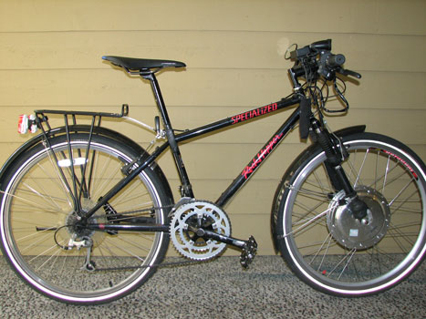

It is a pretty massive hill climb out of Redmond up to the job sites where ever they may be. In November 2009 I began ordering parts for a conversion. Here’s a picture of the 1991 Rock Hopper between ebike modifications. It’s pretty close to the original equipment and easy to describe what’s not:
The rear bike rack and fenders were probably replaced in the last 3 or 4 years, though I can’t say for sure; after arriving in the PNW I put fenders on all my bikes. The ebike doodads and 9C 2806 motor were added in December 2009. Giant 54-Tooth chain ring and seat were added in June 2010. Mainly though I just wanted to show the frame stripped for edification.

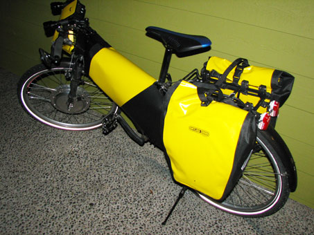

Touring Version: In June 2010 I reconfigured the bike to 63V, and converted the entire rigging for cross-country. The 54-T chain ring was added, installed a Harley-Davidson handlebar bag up forward for tools, again a new seat, added the Ortlieb panniers which could hold 18 batteries a side, for a total of 15S12P, a new HDPE custom black faring, and finished it up with a rear kickstand.

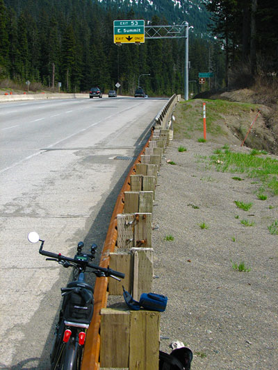

I have to say that this was an eye-catching arrangement; nearly every day I would get someone commenting about it. BTW – the 15S12P configuration bumped me to a new record of 173 hilly alpine miles in a single day with a 45 mph top speed downhill.

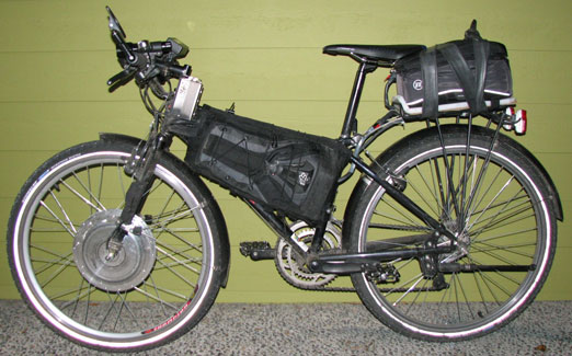

Winterized Commuter Version: Actually this is the Seattle-enabled variant with the extendo-trunk bag. This last month I built a saddle bag from a pair of camelback bags and stuffed 9 batteries on a side for a total of 15S6P. Fastest speeds yet at 47 mph downhill, 34 mph consistent on a flat, commuting 22 miles/day. The Seattle variant adds another 12 batteries for a total of 15S10P. Also added were the Schwalbe Marathon Winter studded tires front and back. I like the geometry of this best because the Center of Gravity (CG) is well-placed and forward which helps prevent the FWD from slipping in the cold icy rain. Due to the saddle bags the controller and DC-DC converter required reorientation. The first week of use was coincident of the absolute worst week of Winter storms and I noted that the bag was seeping wet into the interior.

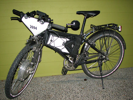

Winter Commuter with interim Faring: During that stormy hell I was on a craze thinking how to gain visibility in the deep darkness of the 5 PM commute. The camelback bags inspired me to consider various inserts, and this is one I put together over the weekend using White HDPE both on the side panels and front deflector. I added the “number” on the deflector for effect; it was my assignment from the Flying Wheels Century event back in early June. Also I took the opportunity to fix some of the problems with the saddle bags; removed the Velcro fastening and replaced it with grommets & shock line. In addition I rewired the main harness to eliminate pesky APP connectors down to a minimum, and created a dedicated pigtail for charging. Unfortunately after hell-week, my Rock Shox were completely blown out and are too old to be serviceable (can’t find parts).

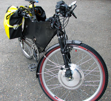

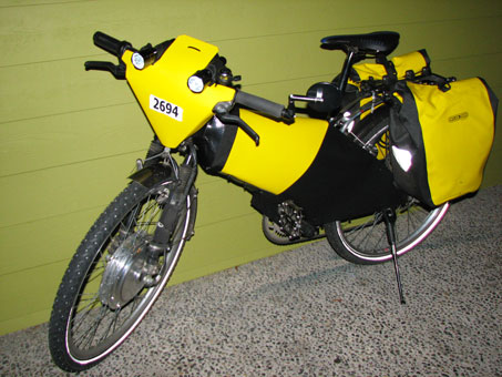

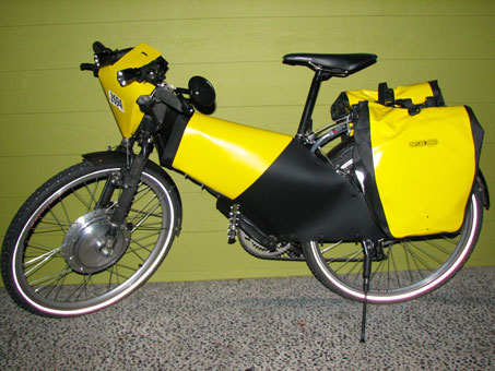

Yellow-Jacket Version: Well, following hell-week, most people split for the holidaze and I was able to work from home. Shocks were out so I didn’t go too far. Found a near-replacement on eBay and it should arrive shortly. In the meantime with all this copious time on my hands and lots of HDPE lying about, I decided that the saddle bags were a bit unsightly and required better rain protection. Thus the Ho-Ho Holidaze aka Yellow-Jacket Version was born. Borrowing extensively from the eye-catching faring concept of last summer, the faring is actually a complex layered construction.
It is Black HDPE on two sides from the seat post to about the middle of the down tube and extending to the rear, although leaving exposed the rear brakes, and fastened with zip-ties. The middle is a sewn assembly (difficult to see in this perspective) of Yellow HDPE wrapped over the major portion of the saddle bags, with ends terminated with Black 42 oz. Vinyl-coated Polyester, grommeted, and pulled tight with zippies underneath (though I may switch to shock line). The front section is another assembly of black HDPE of various pieces cut and shaped to create a console area for my two lighting switches (which are now finally completely secured and do not wiggle about), and armor the forward section against rain, ice, muck, and crud, then covered/wrapped with Black 42 oz. Vinyl-coated Polyester secured by Velcro. Finally a length of 2-inch black polypropylene webbing is wrapped around the joint (tenuous; may replace with something more sheer).
The Front faring is also made of Yellow HDPE and revised to better enclose the forward section and provide a nice streamlined effect over the top of the CA. Again the “number” is applied for effect.
There will be one more addendum when I replace the shock. Or I may decide to do something rash with the front suspension altogether different. That’s the problem with having time off during the holidaze, stuck in a cave during the deep of winter, and trying to stay busy. Perfect time to catch up on movies... Did you know that the Extended Cut of the Lord of the Rings Trilogy is nearly as long as Wagner’s Der Ring Des Nibelungen? OMG! It just dawned on me: Was Gollum modeled after Alberich?!? :shock: :lol:
Anyways ~ the Yellow-Jacket Version without extra bags of any sort is still 15S6P, and may be mated with the Novara Trunk Bag for another 15S4P or (as displayed) with the Ortlieb panniers for additional capacity.
