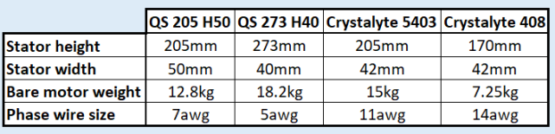

Last summer, I built three ebikes using the enduro frame kits from em3ev. Two of them are powered by QS biggest hub motor that fits a 150mm dropout : the QS 273 40H v3. MadRhino kindly laced these two heavy motors in a 19" moto rim just like the one around which the third motor was built : the QS 205 50H v3. All three motors are fed by unlocked Sabvoton SVMC72150
Having read the entire thread, I totally agree with what has been said about the higher weight of the QS 273 being detrimental to the handling and acceleration. In the same manner, it is also obviously true that those motors can handle larger currents for longer due to their thermal inertia and larger surface area to shed heat. I've seen as much as 30 degrees (celsius) difference between both motors on similar riding conditions. But there are advantages to this motor over the QS 205 that are often overlooked.
I gathered a few key information on the table below of the differences between three well known hub motors for ebike (QS 273 50H and above are not suited for ebikes as they require a 200mm dropout)
As far as my understanding goes, the amount of torque per ampere also increases as the height of the stator (diameter) augments. It does so because the length between the road and the rotor is decreased, indeed shortening the lever. It is the same phenomenon as when you decrease the size of your wheel ; the smaller the wheel, the higher the torque.This is why despite having a similar stator width, the Crystalyte 5403 outperforms completely the old Crystalyte 408. A few years back, I asked Justin from ebikes.ca about the relation between the stator width vs height by comparing a Crystalyte HS35 (205mm height, 35mm width) to a Golden Motor Magic Pie (273mm height, 18mm width). He answered :
The total magnetic area is half as wide (35mm vs 18mm), so it generates only half as much linear thrust per amp. However, it is also 33% larger in diameter (273mm vs 205mm) so you have 33% more length of magnet, and that brings it to having 66% as much linear thrust as the magic pie. But, the thrust on the Magic Pie is also acting at a larger radius (33% larger again), so in terms of torque the magic pie ends up being about 89% as much as the HS35XX series. The larger diameter means that it can achieve 89% of the torque of an HS35 motor with just 69% of the magnets.
Please correct me if I am wrong, but my point is the same calculations applies to the QS 273 40H vs the QS 205 50H ; sure it's heavier but the thrust per ampere is higher too ! That means not only it can take more current, it generates more torque with it.
Edit: The QS 273 ebikes are running 18s 48Ah lipo @ 225A battery current limit good for 15kW nominal (as you cannot multiply battery voltage with max/peak phase current to calculate the ebike power because these are waveforms (square or sine) that don't get their current "multiplied" in a way that doesn't respect Watt’s law. The power you see on the cycle analyst/wattmeter is, minus small losses, the power your motor gets)
