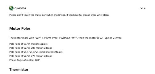

Could someone tell which motor this is?
More technical information is more than welcome..
Printed on the motor:
QSMOTOR-R
DCA QS60/72V2000WJ 251031 6002199
(See also pictures attached)
Motor got 24 pole pairs (counted 48 clicks in a full rotation) 48/2=24
its got NO Temp sensor. (No white wire)
2000W with 35H magnets.
Motor had been sold (on AliExpress) as a V4!?
I've send QSmotor.com an email but had no luck (see answer below) the answer came from siaecosys!
_______________________
Hello Sir,
at present, we cannot determine the exact motor model solely from the appearance images. However, what we can state clearly is that the QS260 V4 must have 16 pole pairs; any motor that does not have 16 pole pairs is definitely not a V4 version. Secondly, if there is no white wire inside the Hall plug, it means the motor does not have a temperature sensor.
