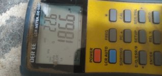

I don't have it for the new one. But I can try to measure it on my older QS205 stators with the DE-5000 LCR meter to give you a starting point if it will help.
@amberwolf-which turn count motor you have. Look like QS don't make 7T motor any more. I am more Interested in the 6T they may still make. Much appreciated.
I got the two stators out, and they have markings engraved on the edge of the support, but they're hard to read.
The one with the missing axle appears to say 30x4, with 33 just past the rivet. THe phase to phase inductances and resistances as measured thru the ~meter-long (8g?) phase wires by the DE5000 using it's shortest are as follows for each of the three phase pairs (I did not note if they were YGB, etc). (I couldn't measure at the windings without removing all the heavy duty fiber insulation wraps on the joints and the tiedowns)
188.2uH 0.044ohm
186.3uH 0.053ohm
186.6uH 0.050ohm
20230714_200425[1].jpg20230714_195902.jpg20230714_195919.jpg20230714_195956.jpg20230714_200011.jpg20230714_200027.jpg20230714_200039.jpg
The one with the broken axle appears to say 40x3, with 11 just past the rivet.
The phase to phase inductances and resistances as measured thru the ~meter-long (8g?) phase wires by the DE5000 using it's shortest are as follows for each of the three phase pairs (I did not note if they were YGB, etc). (I couldn't measure at the windings without removing all the heavy duty fiber insulation wraps on the joints and the tiedowns)
98.5uH 0.023ohm
96.9uH 0.023ohm
97.1uH 0.023ohm
20230714_200203.jpg20230714_200207.jpg20230714_200242.jpg rest of files in next post because it will only take ten per post.
Hopefully that helps someone, even if they aren't the right winding to compare with for yours.
Much appreciated@amberwolf. Wanting to do some simulations on grin simulator. From info seen cnQS, the 40X3 could be a 3 turn and the 30X4 a 4 turn @72V.
