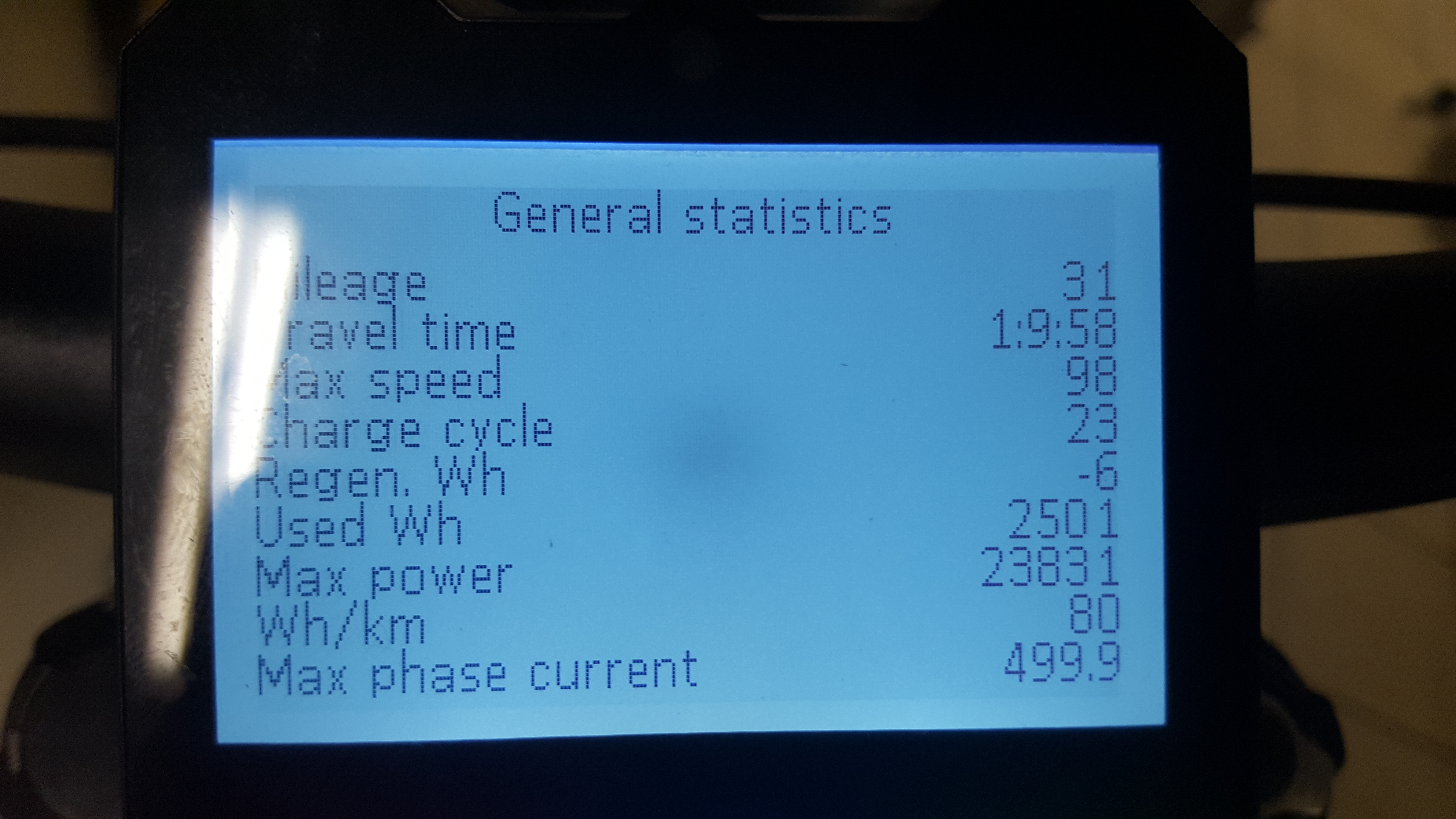

What motor is it, and what phase amp can the controller deliver?
I had a bike like that with a qs 205 50h 4t. With a 17" rear wheel it was just on the point of starting to power wheelie with a controller that could deliver 350pA.
A small bump or so and the front wheel would lift.
With 500pA it would flip if you held full throttle from stand still and power wheelie up to pretty high speed.
I think with the controller that could do 350pA it did about 180battery A and with the 50pA controller about 350battery A.
I only find this record from a testride with 500pA:
It dosent really say what battery voltage or battery amp, but somewhere a little over 300bA I suppose and around 75V maybe.
