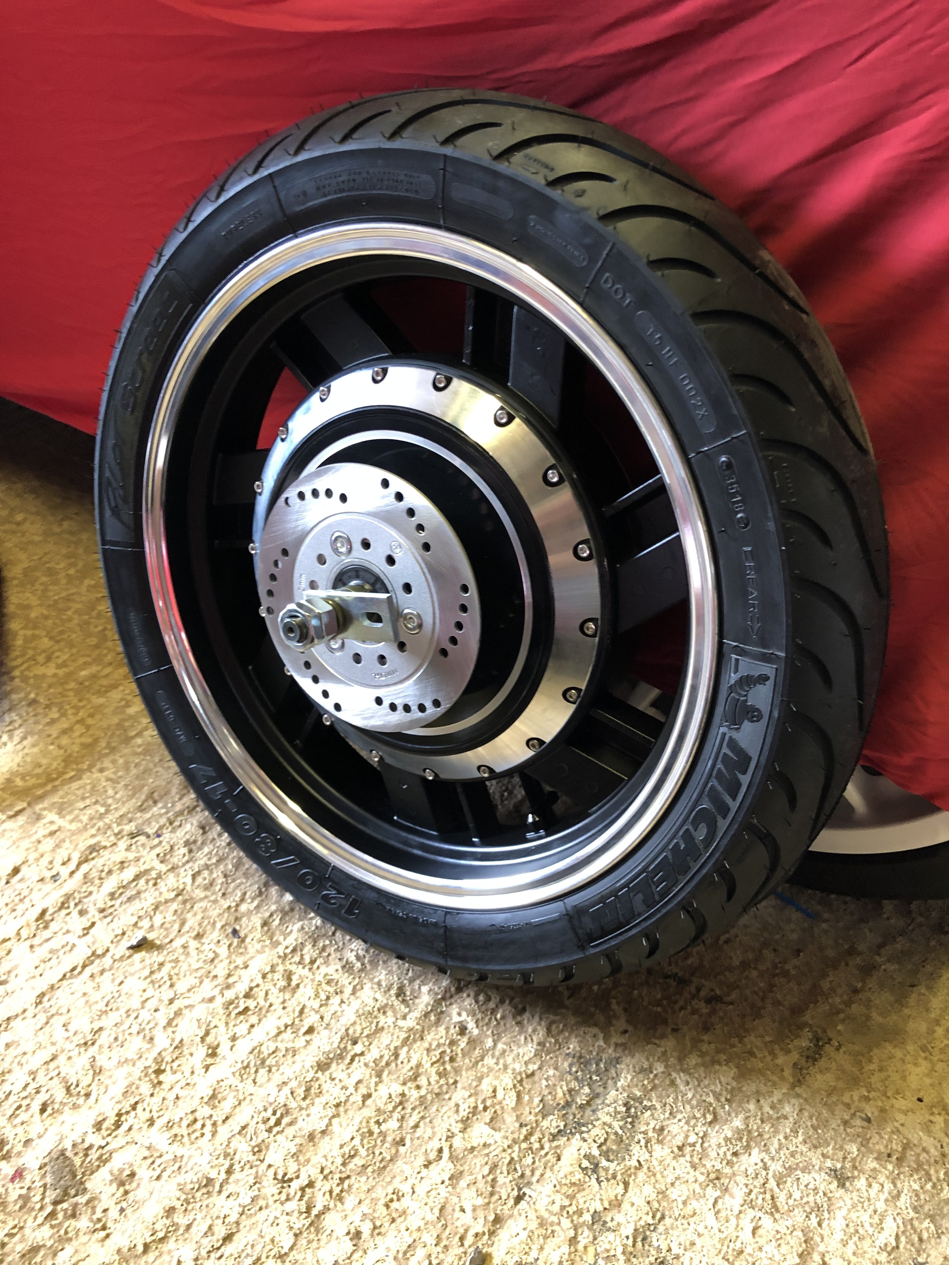

I’ve also sourced a tyre and used the cable tie method to get this onto the hub motor rim, and then removed the valve core to use a couple of good blasts of compressed air to seat the bead of the tyre all the way around the rim. Seems to be seated OK and holding pressure fine. I can recommend using a Black and Decker workmate bench for mounting the hub motor rim on to make this a lot easier!

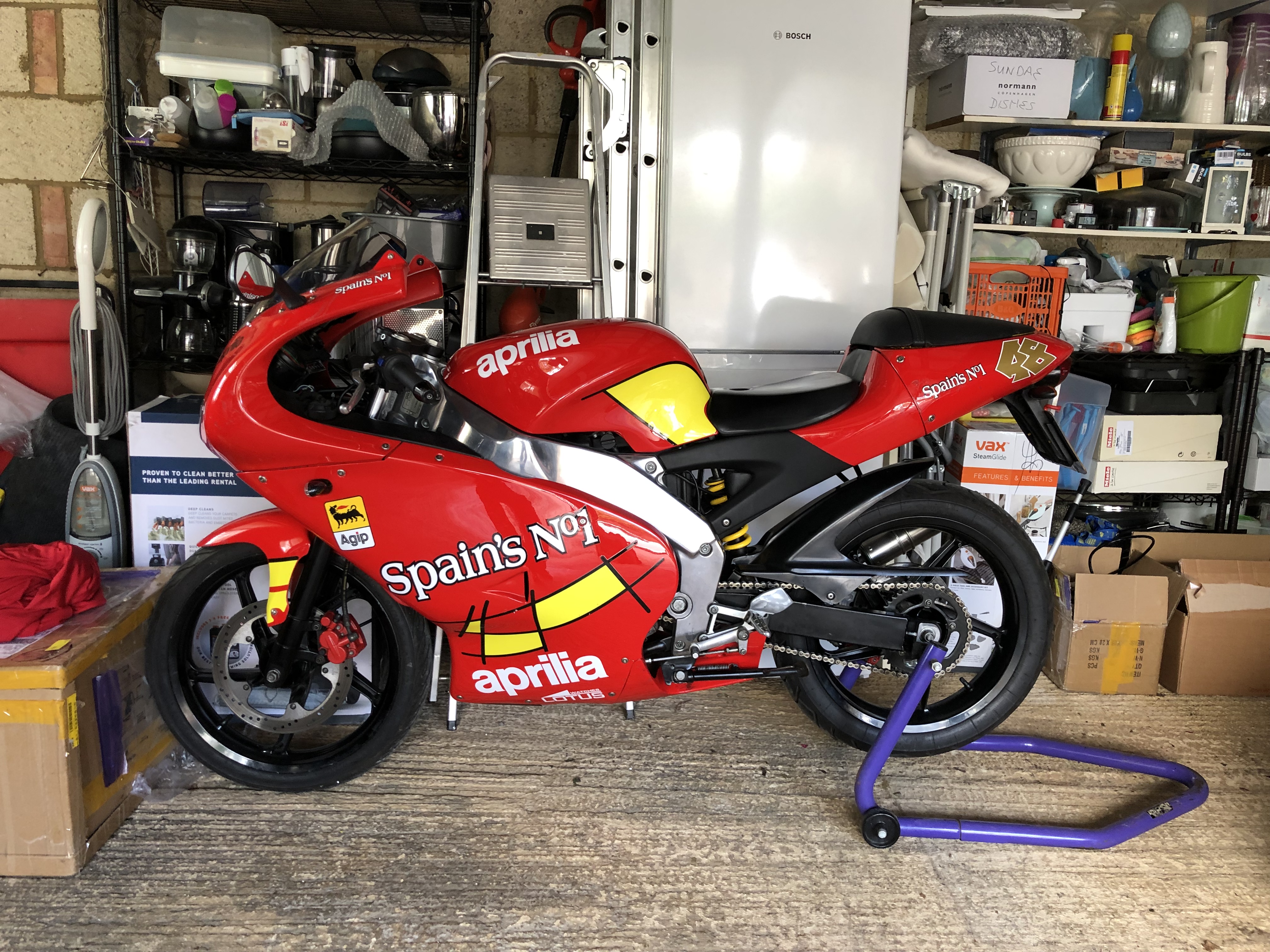

Oh and I suddenly realised I’ve not actually posted any picture of the donor bike that I’m using here.....
Apologies for long overdue update ... got the motor / controller/battery all set up and configured off the bike to sort wiring out etc.
Then just after Christmas started in earnest modifying the Aprilia swing arm to fit the QS Motor. I knew the width of the swing arm would be tight but the design of the plates I’d had made up for the mounting the axle/axle flats gave me another 150mm each side of the swing arm. All looked OK until I came to fabricate a mount for the rear brake caliper .... then it became very apparent there was never going to be enough room on the brake disc side of the swingarm to mount the caliper and get enough clearance.
I wanted to avoid cut/welding the swingarm so eventually had to make the difficult decision to abandon the Aprilia as the donor bike and look for something with a bigger frame/swingarm. After some searching I was able to offload the Aprilia and found another donor bike.
It’s no where near as well built as the Aprilia but it’s a bit more suitable for what I’m doing here ... a Yamasaki YM50-RE!
