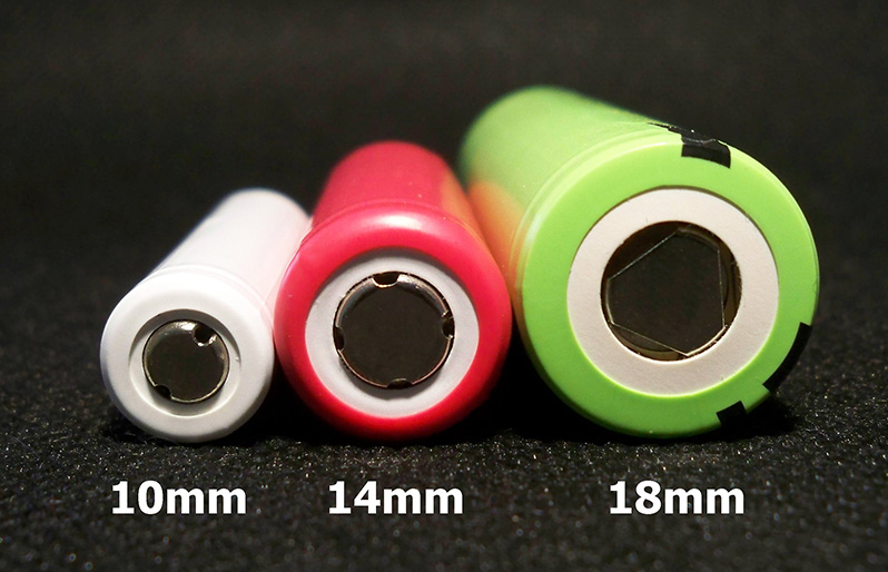

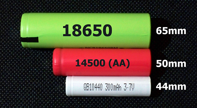

10440 size is more known as AAA - it means that the cell is 10mm in diameter and 44mm long. In Lithium world 10440 is a rare size but you can find 3.2V LiFePO4 and 3.7V Li-ion models just by googling "10440". To feel the difference let's take a look at 10440 (AAA) next to 14500 (AA) and 18650:

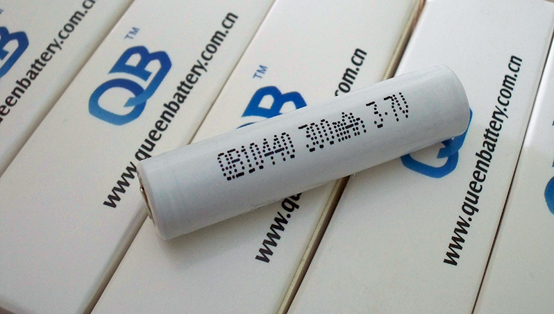

This review's hero, Queen Battery QB10440, is a flat-top unprotected 300mAh-rated cell which also can be ordered with add-on protection PCB and button-top cap.

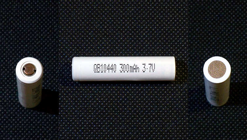

The cell's heat shrink tube shows brief specifications but has absolutely no data about production date or batch number.

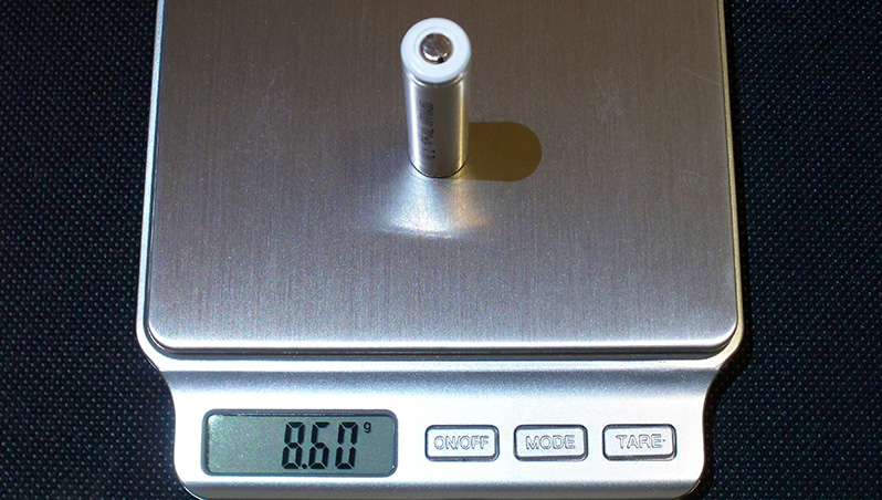

Measured weight of the tested cell was 8.6g and the actual dimensions - 10.2×42.9mm

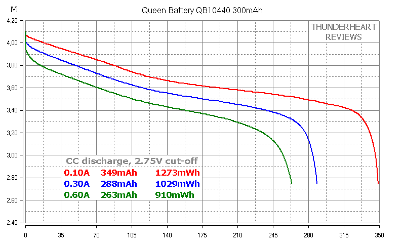

Queen Battery QB10440 300mAh capacity test results:
In case of QB10440 0.2C (for checking nominal capacity) is equal to 60mA and 0.02C (charge cut-off current) - 6mA. In both cases my battery tester allows 100mA as the minimum value which could be set, so instead of 6mA i cut the charge at 100mA and instead of 60mA test i did 100mA one. Even in those conditions QB10440's capacity was about 350mAh at 100mA discharge!!! I suggest that once it's charged using 6mA cut-off and discharged at 60mA it's capacity will be around 400mAh. At 300 and 600mA the curves look good. This guy handles 2C rate easily but i'd not recommend to go much higher than 600mA. This cell is not meant to power amp-hungry devices.
So, quick pros and cons:
+ more than 350mAh real capacity
+ up to 2C discharge rate
- 2.75V discharge cut-off current (harder to find a suitable protection PCB. Solution is to buy protected cells).
