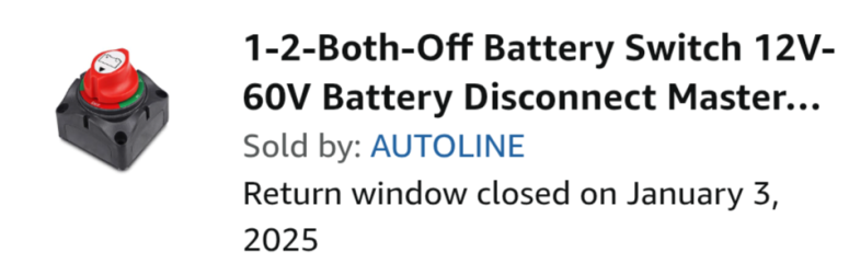

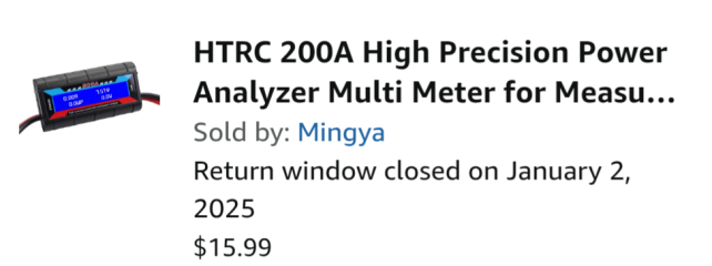

The concept is effectively a switch box with a number of nichrome resistive loops connected in parallel. This would allow me to step the resistance of the loop as the voltage drops, giving an approximately continuous discharge rate (importantly, I do not need to know the capacity, just the thermal situation, so approximately continuous is acceptable).
Each nichrome loop would be loosely coiled around a fire brick or similar, probably with a blower fan over them.
For a first test, I want to configure this tester to do a continuous discharge between 50-60A from a 72v nominal battery. My calculations give a total of 8 nichrome strands of 8.4 feet long (1ohm/ft at 22awg), starting with 6 in parallel at full charge, and ending with 8 in parallel by 3.15V.

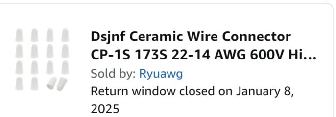

I haven't made Nichrome heating elements before, but my preliminary concept is to try using these ceramic wire nuts to attach the nichrome, the light switches to allow toggling (theoretically each would only be under 10A, and a standard circuit is 15A).
I got these multi block connectors to help configure this, but I may switch to proper crimped bullet connectors everywhere that's relevant. Each heating element would be wrapped around a brick, resting on a silicon carbide kiln shelf.
