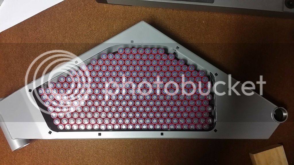

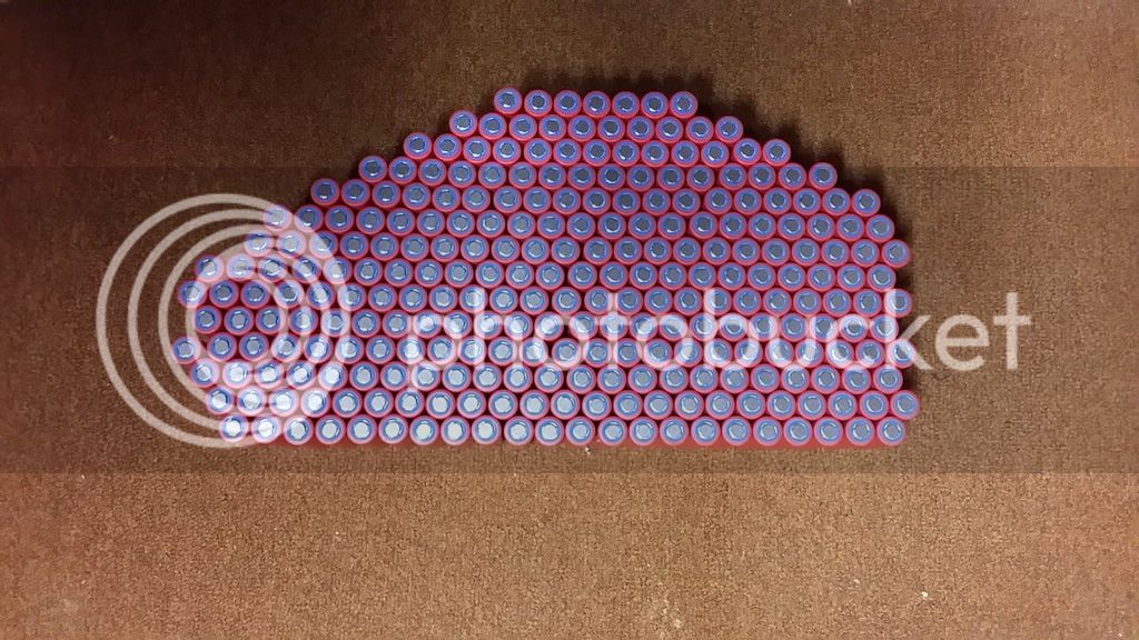

EDIT: made battery count mistake, I thought I had 240 cells, but in pictures it is actually 270 cells. I can get 274 cells in the frame if packed together. There is still room around the edges for some balance wires.

I placed 240 18650 cells inside the battery compartment and it fits nicely, with a little room around the edges also. I was getting a little worried if I would fit the 240 cells, but they fit. Could probably fit a few more, but that is about it. If you got creative you can fit cells in the front of the bike.
It took forever to just line up 240 cells, I can imagine the hours it will take me to build and weld the pack.

240 Sanyo 3500 MAH cells inside frame

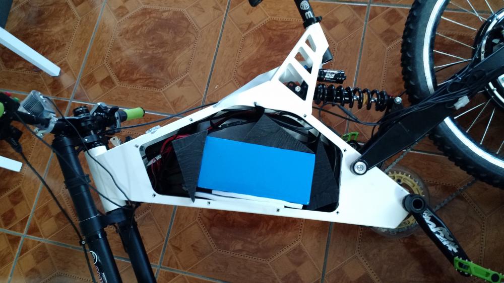

It is so much thinner than my Raptor 165. Looks to be like 1/3rd the width. Can't believe I'll fit a 3KW pack in that, when my Raptor 165 only has a 2.3 KW pack.
Head tube cut at top by 10 mm. Looks good.
Thank God I won't have to deal with Lipo Packs anymore. Look at that mess, took me ages to remove the pack for service.
