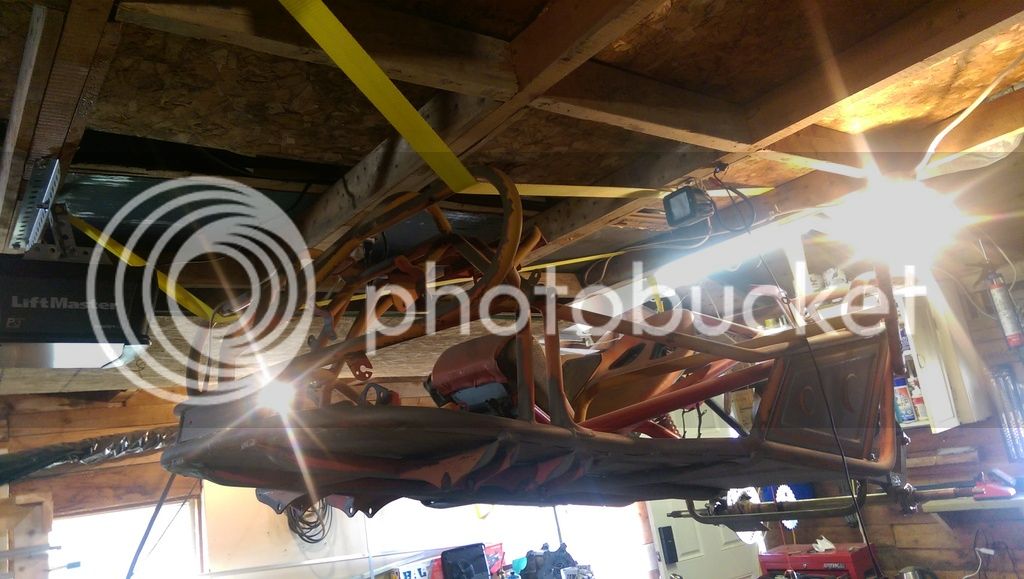

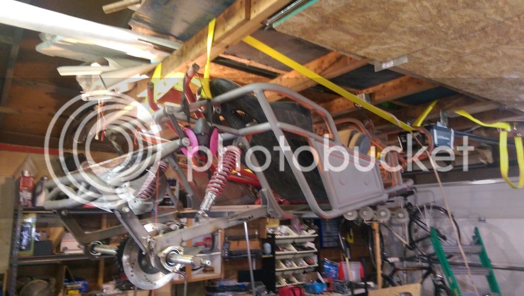

Short story long I'm in the final stages of building an all electric dune buggy using a Golden motor 72vDC 10kW Water cooled BLDC (Impressive build quality aside from the output shaft being 3 thou out of round) and 3 x Tesla built 3kWh 24v cells in ran in series.

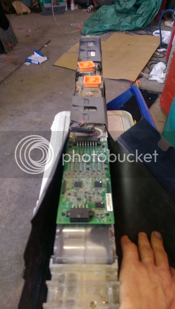

Should I be running a proper 3+ stage 72 volt charger, 3x 24 volt smart chargers to each cell or does the BMS manage charge cycles and should be supplied with either CC or CV power source?
I had no idea when purchasing these cells that they were quite rare and that information about them and their BMS would be as scarce as it is. I ran a search on your forum and found only one thread that relates to it but there's nothing much worth mentioning.

Here are a few pictures of the project and its components
