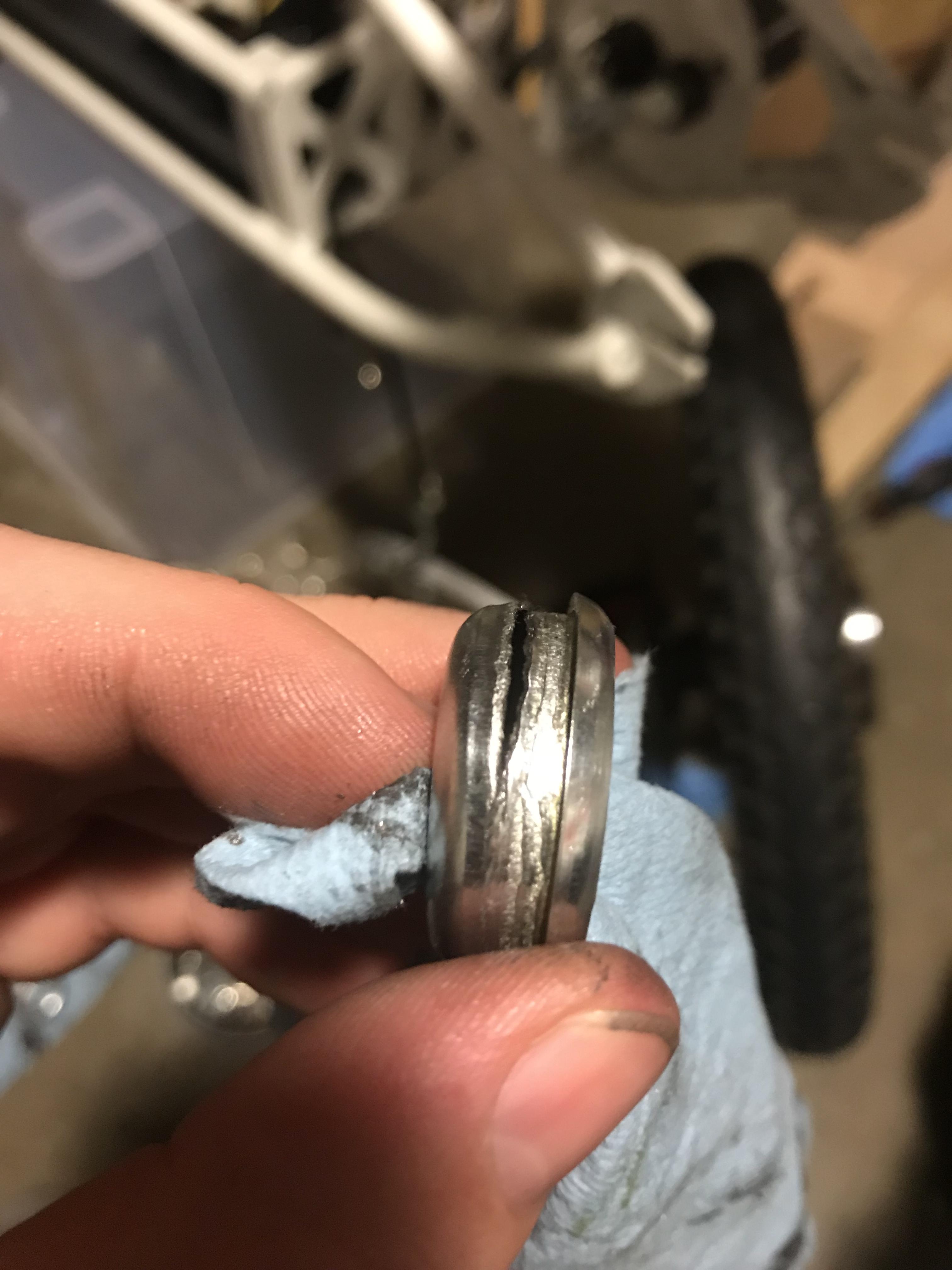

I picked up a Razor EcoSmart Metro for free! The previous owner said "I dunno, it's broke and I don't care" so, awesome.
Turns out the rear bearing cup was splitting in half. Which led to the ball bearings falling out, the axle coming loose, and the chain popping off. The right side components were chewed up and a complete mess.
Ordered a new rear tire/assembly, swapped it in, and the scooter is back to like-new condition. Nice.

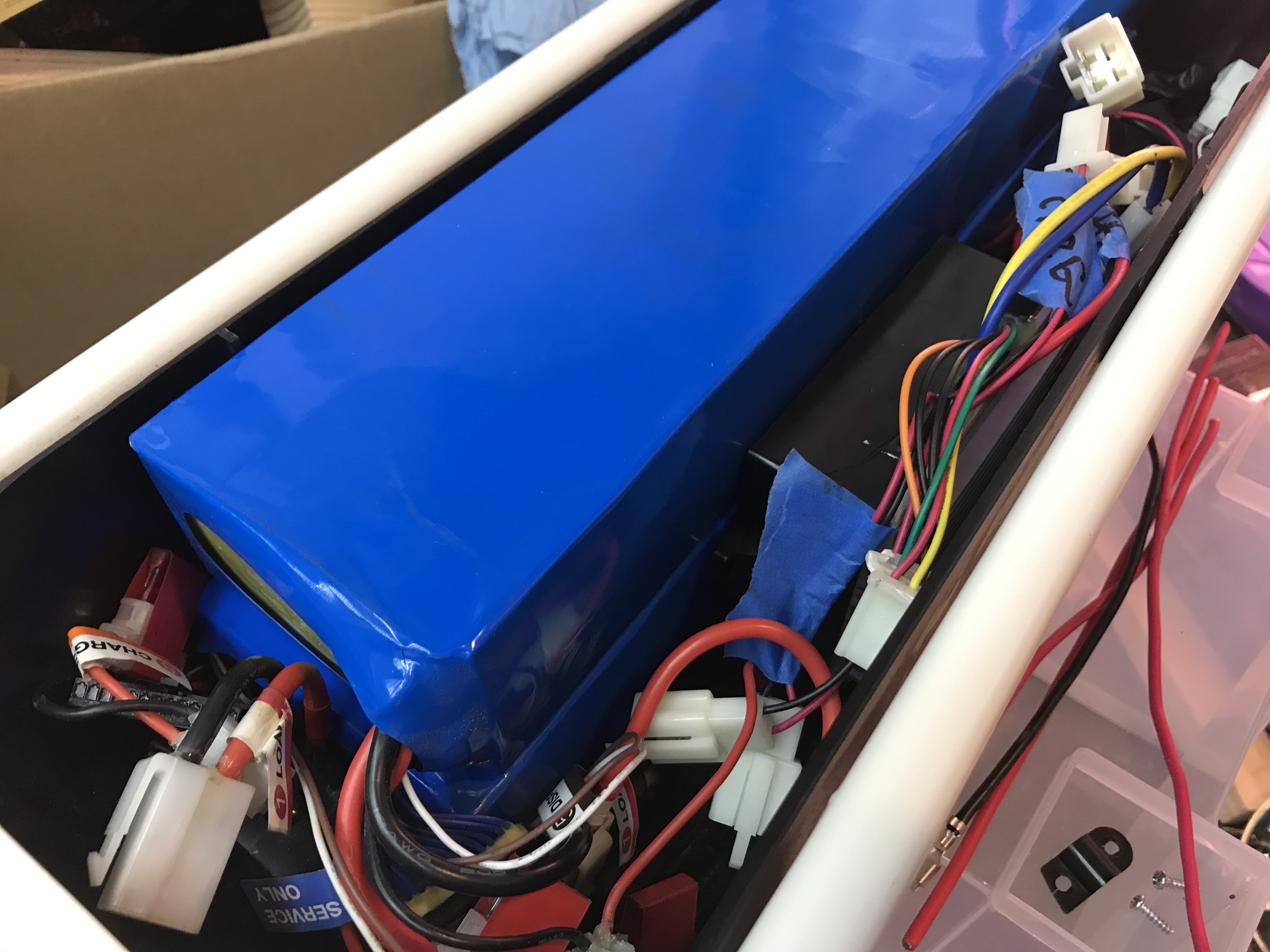

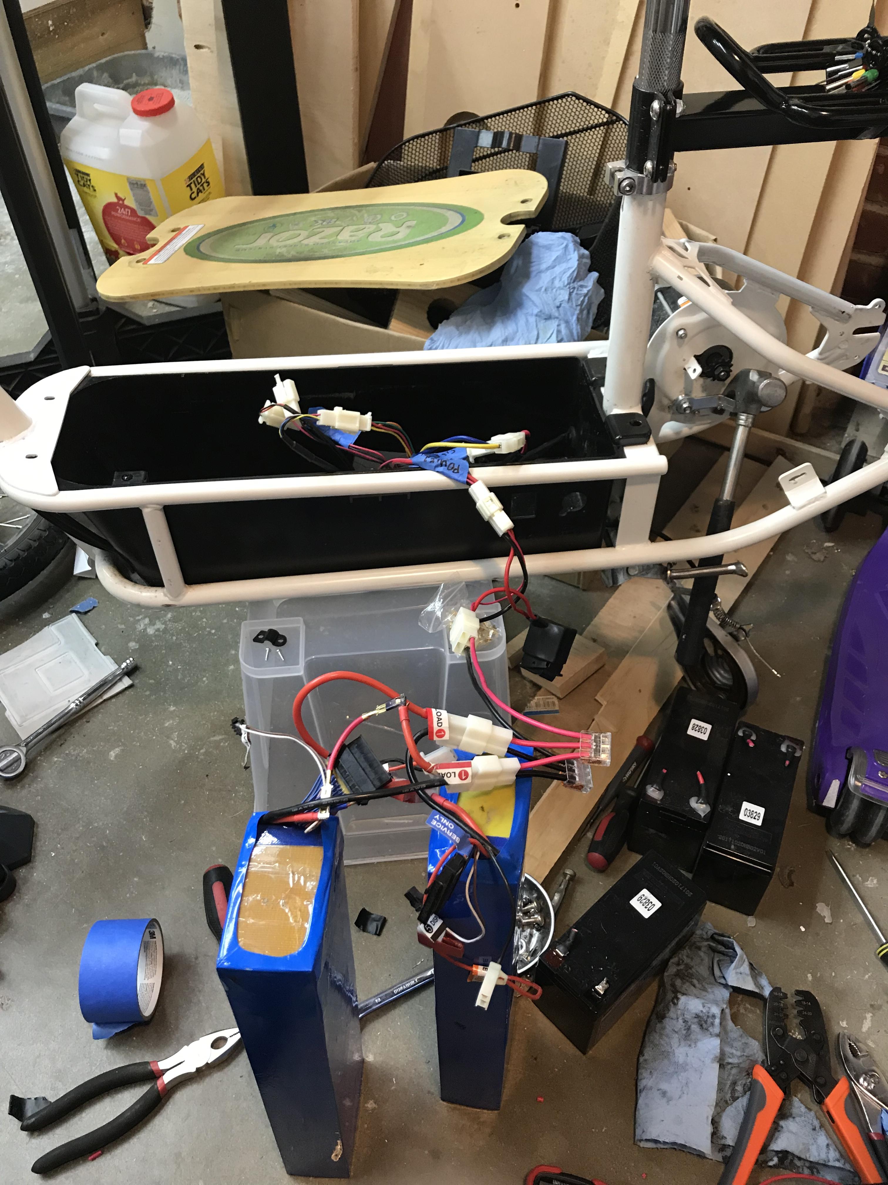

While I had it under-the-wrench I realized I had some old 36v LiFePo4 battery packs from old, broken scooters around and decided to wire them up in parallel. Works perfectly.
I did have to move the controller to the side, but no big deal.

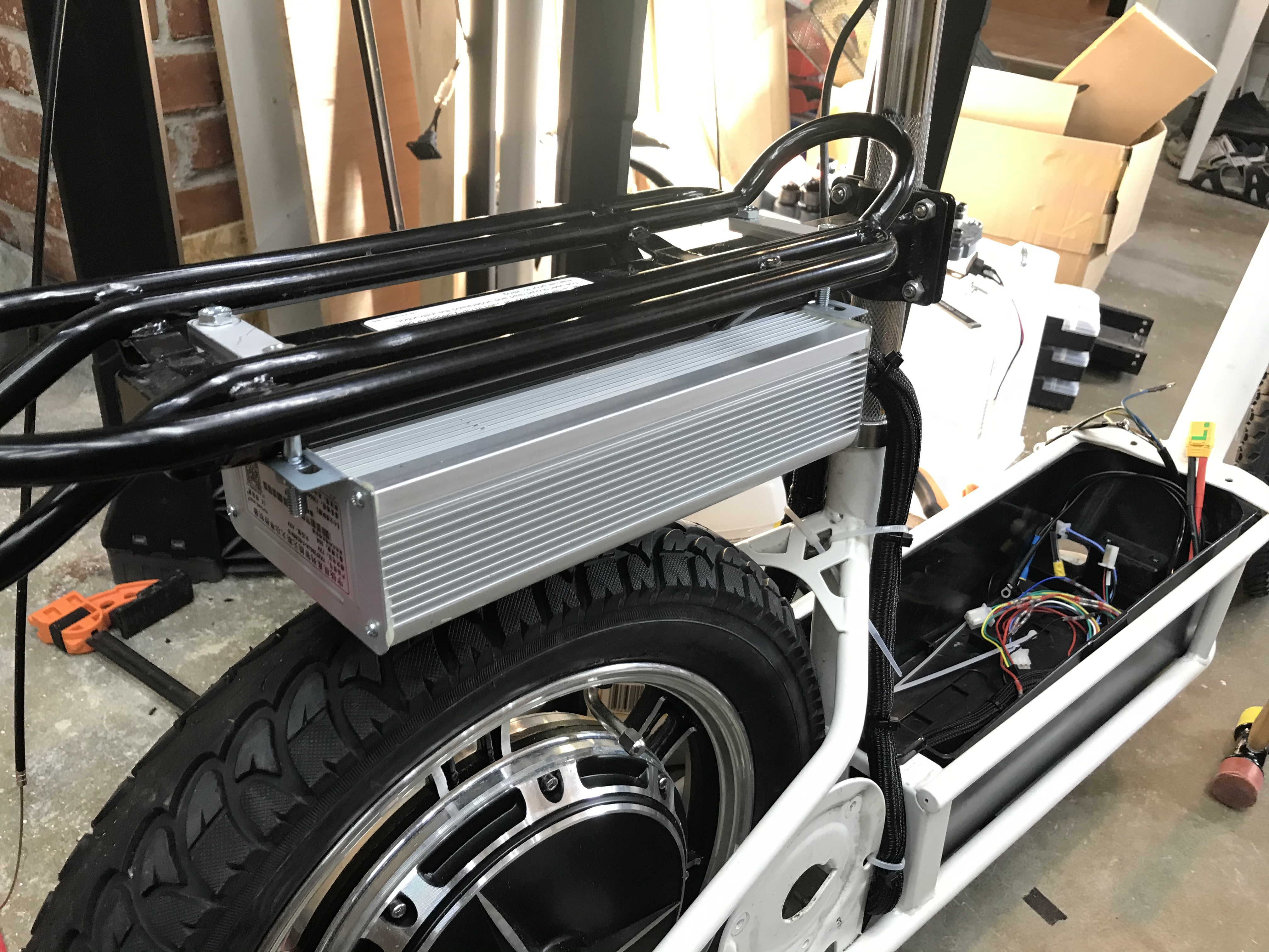

Mounted from aluminum and the controller on the rack:

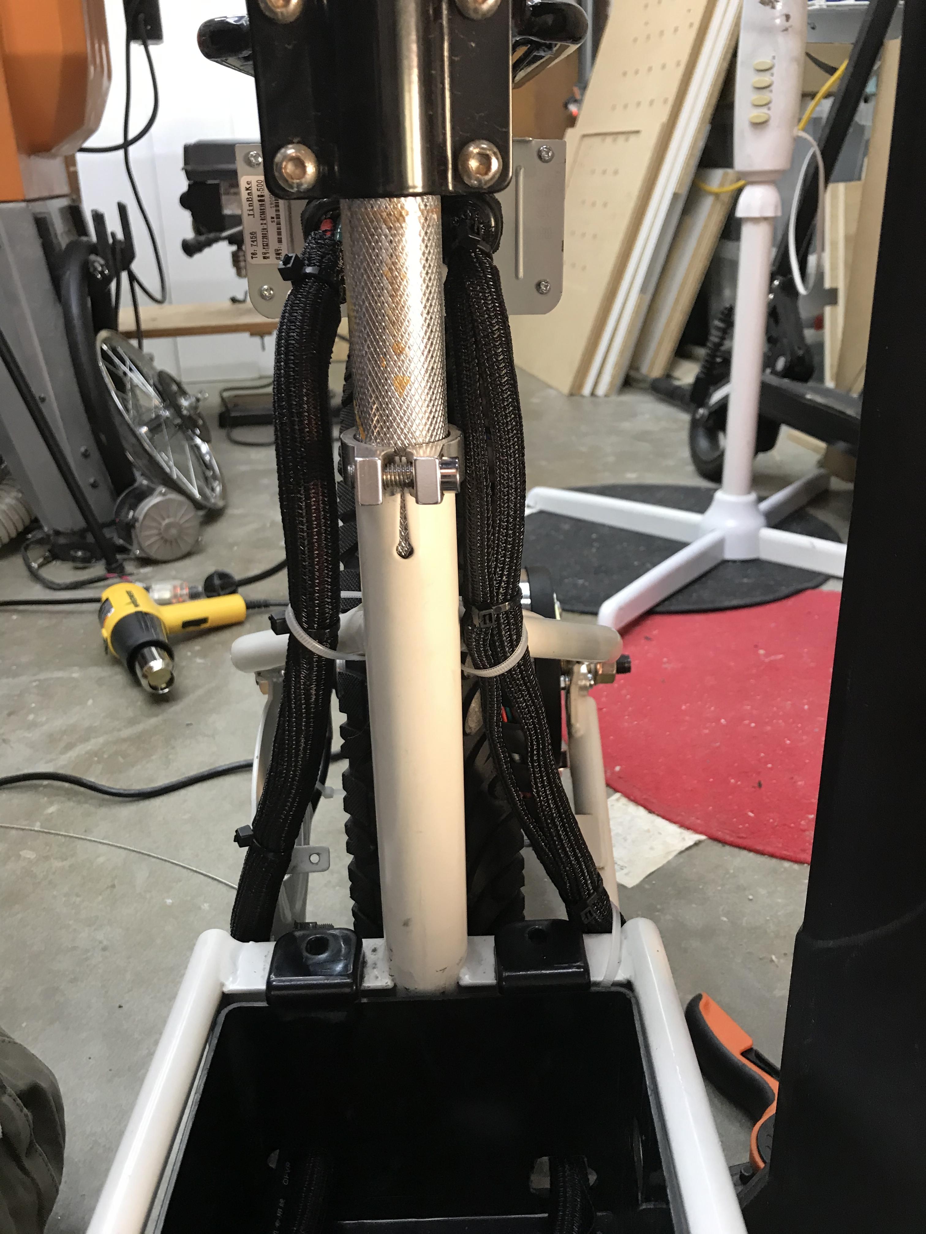

Cable routing:
Had to extend 20+ wires. That was....fun:

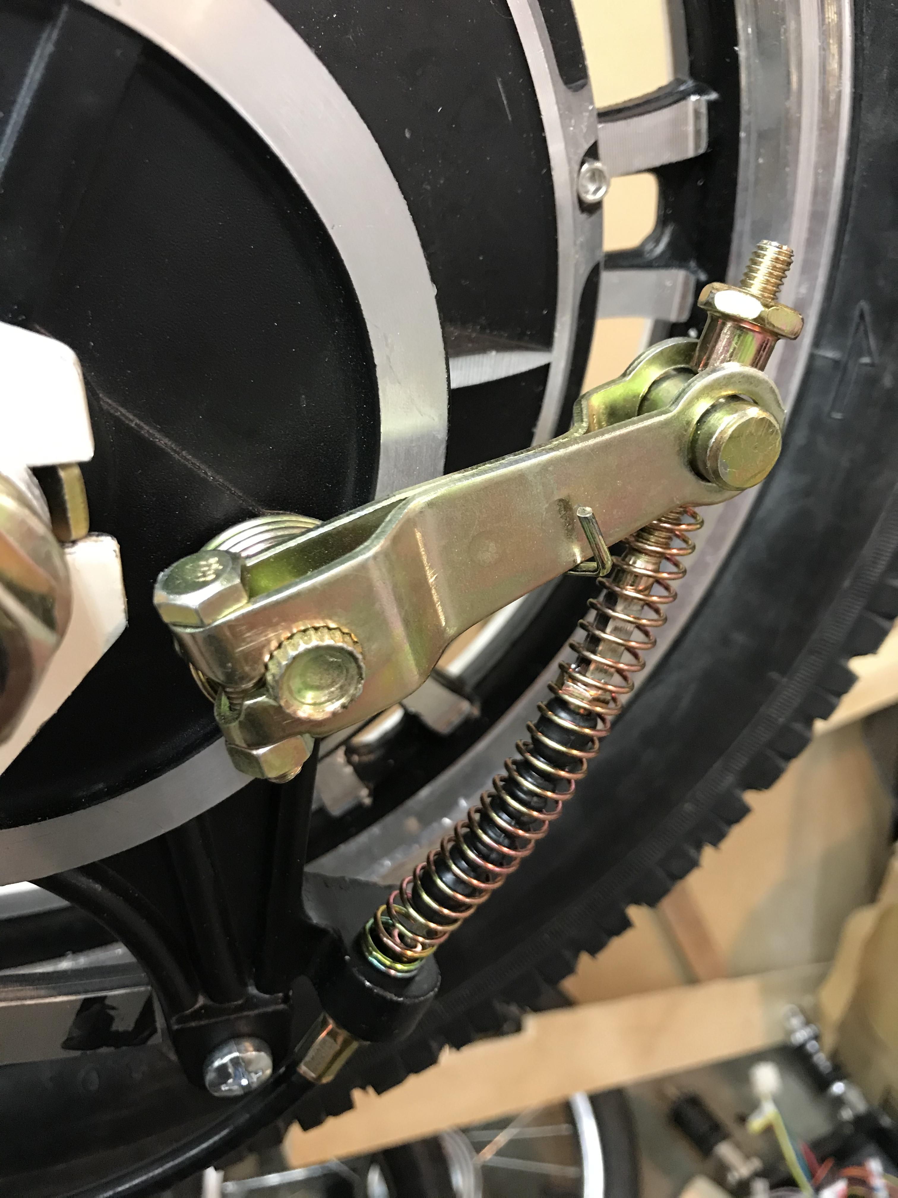

Also fun, the motor uses a motorcycle brake system, so I had to get a new lever and brake cable. Ooops :D

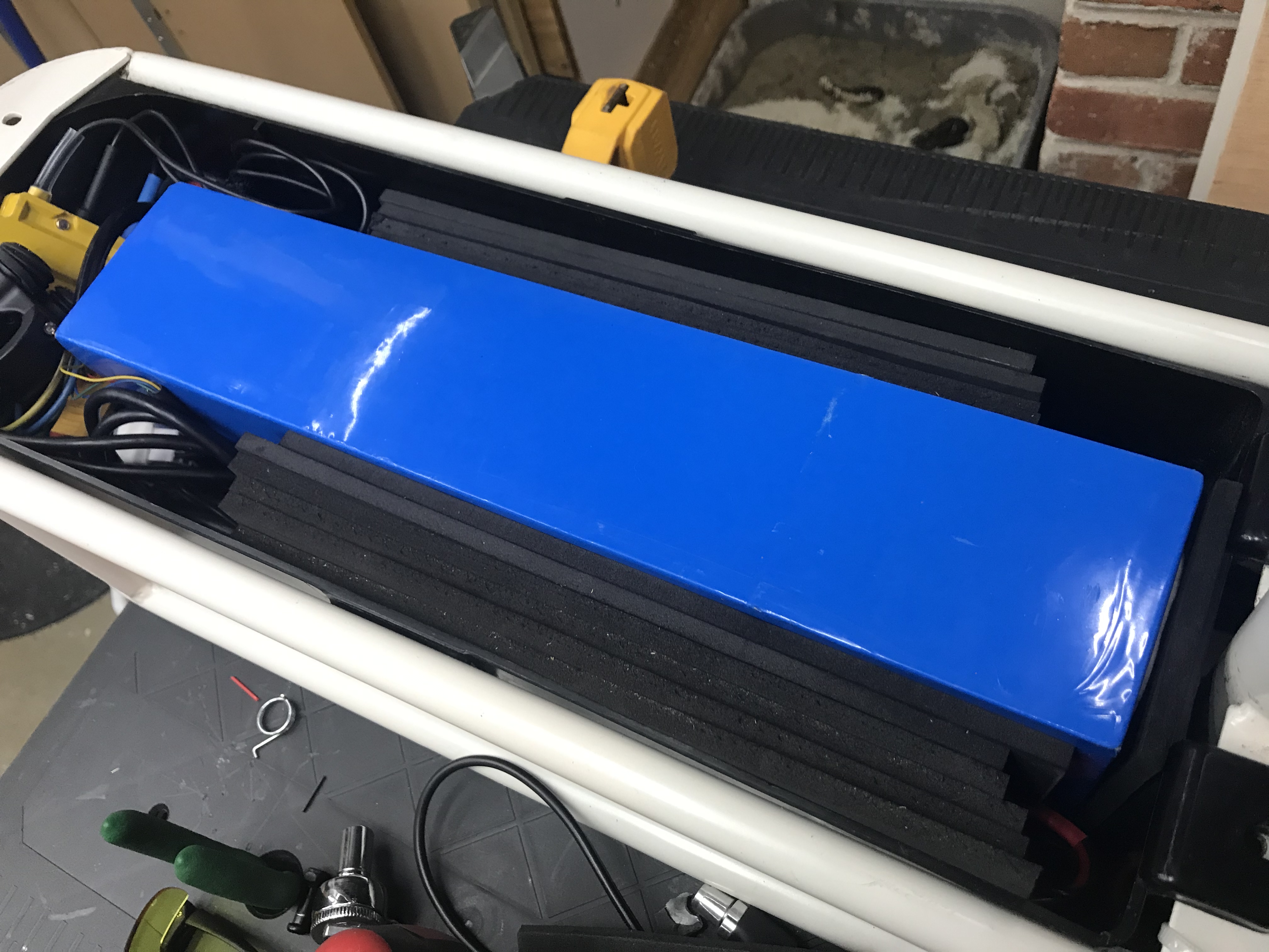

Finally, here's the deck with battery, wires, and foam padding all installed:
And it works GREAT. I can get it to blast along at 43mph (which is way to g'damn fast). And that's without putting it in the "+15% more" mode. It'd get reaaaaal close to 50 if you did that and weighed a few pounds less than me :)
