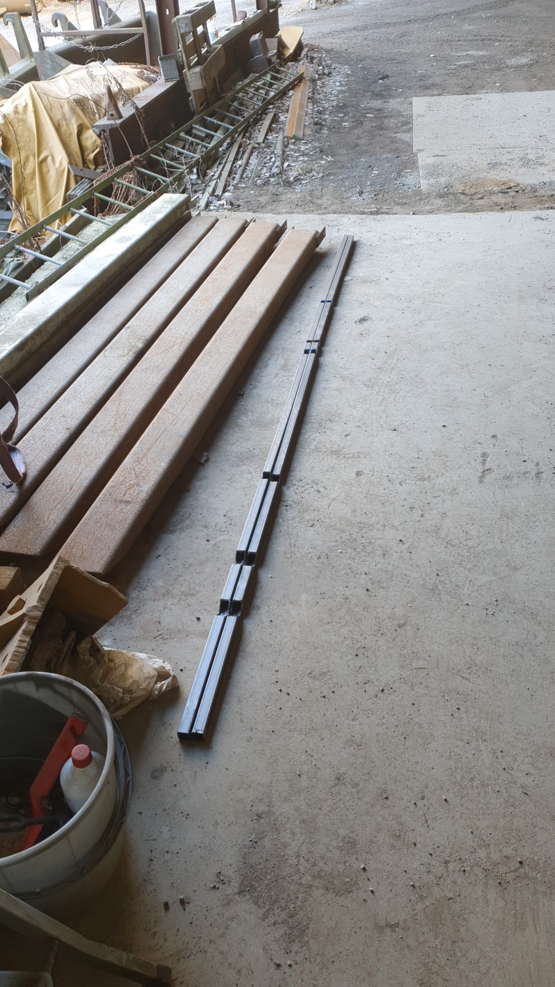

Ill be getting 3x2m lengths of 30mm square and 1x2m length of 25mm square tubing, both with 1.5mm walls
Two 30mm of which will have wedges cut in it to bend into the shape pictured, minus the front upright, totalling 1.88m each.
The third 30mm x 2m tube will be cut into the two front upright 435mm parts and leftovers will be used to widen the fork.
This should also leave enough for the foot rests, which im thinking will be a single bar that bolts on at the lower end of the front, as well as someplace else along the side or bottom for compact stowage for when the whole thing is put into the back of my car or whatever.
Im not 100% sure how wide i need to space the two sides yet as im still waiting for the front rim, ive got a measurement for the front rim itself. 122mm wide, but the seller doesnt give the hub width/outside of bearing to outside of the other bearing.
But thats not much of an issue as ill have a bit to do before ive get that far,
Whatever the distance i will be cutting the 25mm tubing to length for joining the two main parts of the frame at each bend.
Along with two or so extras under the seat for ease of mounting it+the batteries.
A brace above of and in front of the rear wheel for putting on a rear light and a fender.
A couple of braces along the bottom, perhaps for storage inside the frame?
A brace in the front where the diagonals join the upright to mount a blanking plate to protect the inside of the frame from unnecessary road dirt.
Im not a great welder but i can booger stuff together and will be putting in gussets at the main corners of the frame.
Am i going overkill? Am i going way light? Have i missed anything obvious?

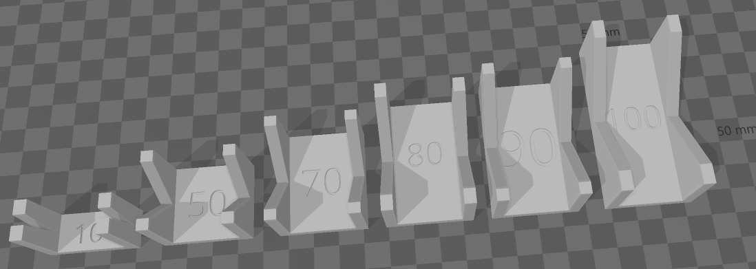

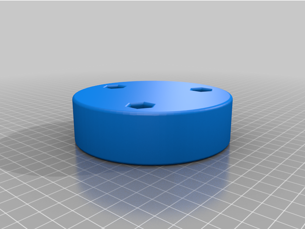

2x350w hoverboard motors bolted together, holes drilled, rim side adapters printed,
Printed?
Would be interesting to see the whole dual-motor-sandwich idea, parts, and process. Not many people try this; last one I recall was years ago where Farfle paired two magicpie stators and rewound them to be a single one; a different process from yours most likely.

And then onto the frame:

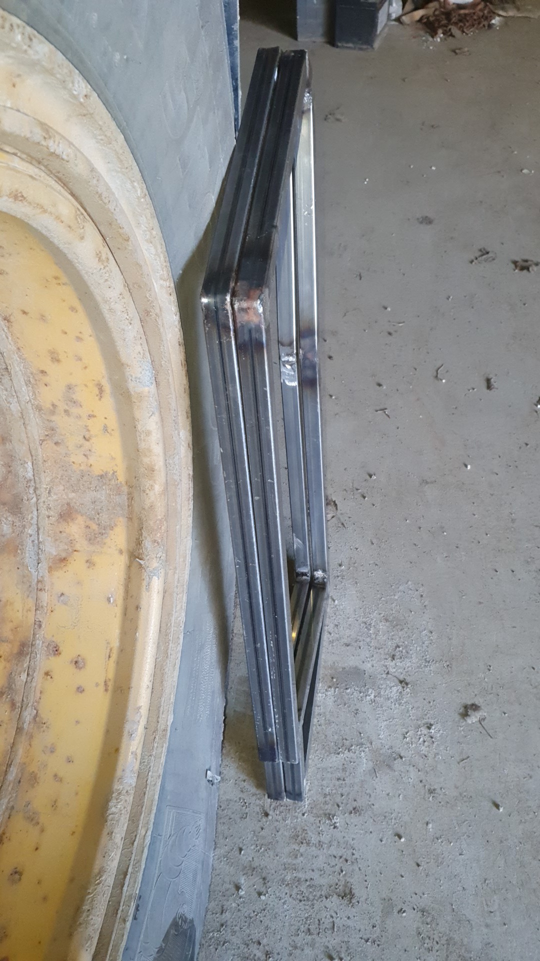

I recommend a diagonal from one front corner to one rear corner, preferably from the steerer top front corner to the dropout botton rear corner, to stiffen the frame. Unless you need the frame to be open for larger cargo access, these can be welded in place. If you need them to move out of the way for cargo access, you can use a quick-release-lever nut at one end of one of them (with it's bolt welded into the frame corner it attaches to), and a hinge at the ohter end of the same one, with the other side's diagonal welded in place.
Also: How do you plan to get the rear wheel in and out of hte frame, with the axle above the lower frame members? And what kind of dropouts do you have planned? I'd recommend pinching/clamping dropouts (there's a lot of examples around the forum, including some secure-but-ugly ones on my SB Cruiser).
As long as your welds are secure (full penetration, good fill, etc), and you're not welding incompatible materials, etc., you should be good. See my SB Cruiser, CrazyBike2, Mk IV / V trailer, etc threads for examples of not-great-welding that has still worked. :oops:

Printed?
Im using the files put out by Nicholas Cardoza.
Im confident enough that they ought to hold without looking too good :p
Last year i welded two bits of 3mm wall square tubing, feet/fork holes for while transporting, to the bottom of an extension boom for a telehandler and they have held up to the abuse.
As well as adding reinforcing strips to the bottom of excavator/loader buckets without any parts falling off yet, knock on wood.
So revising with your points and my own idea/wish for the look and removability of the rear area/wheel.
What do you think? :)
Thanks for linking that--looks useful for assorted adaptations (with possible modifications to fit different applications).
That should probably work. FWIW, I don't think you need the shorter triangle in the front, with the long full triangulation, assuming the rest of that front is just a "box".
If you feel like it, there are some free FEMM tools out there to see where the stress points are in a frame, so you can correct them. I keep meaning to try them out but haven't gotten around to it (I really should, given the loads I put on stuff).
