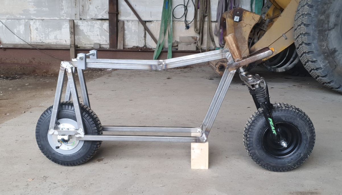

DIY (Mini) ebike/moped -> square tube frame, hoverboard motors - does this look reasonable? Any obvious oversights?
Isn't that what sledgehammers are for? :p
I did try stomping on it with a wedge placed under where i wanted the bend, didnt want to use a persuader as i thought it might crack welds or bend the tubing somewhere id prefer it not to be bent or possibly bulge the side.
Figured cutting and rewelding would be more predictable ;)
Today ive cut axle mounts from hoverboard chassi parts and separated the tubes going into the lower suspension tubes from the crown as well as marking out+centre punching the holes im going to drill in order get the bolts back in them, gonna see about welding them up tomorrow, just need to figure out a good way to clamp them so they stay parallell when welding.
I think ill be doing a couple of spots around the circumference initially so i wont be getting as much warpage as a single larger weld straight off, thats what i did with the second frame half and it got only very minimal warping as can be see in the previous picture.

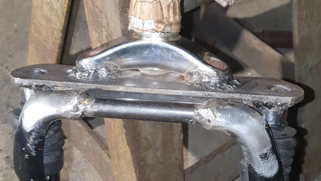

Luckily i think my fork/crown surgery was successful, the suspension still moves alright.
Spent quite a bit of time in trying to get the parts clamped together just right before putting the welder to them and then did that spreading-out-smaller-welds-around-the-whole-joint in order to prevent warping before burning those over to make it solid.
At the moment its just the crown and shock tubes welded to a 5mm plate but im going to add some reinforcement, probably A rib running horizontally across it or gussets between the shock tubes and the plate. im not worried about the head tube part as it should be really solid in being welded around on the outside and kinda plug welded through the original holes that went into the shock tubes.
Forgot to take pics but ill see about adding the reinforcement tomorrow and take pics then.
Got a reinforcement added in the form of some tubing welded to the bottom of the plate, with quarter moons cut out around the the shock tubes and then welded, preventing bending of the plate itself and stabilizing the tubes.
My welds look decidedly ugly but they have penetration so should be strong.
Also brought the rear wheel to get an idea of how wide the frame sides should be spaced and after drilling holes for the axle clamps it turned out to be 155mm, i tacked in the lower front side to side connection so the frame now holds its shape with the rear wheel attached.
Did a quick mock up by just clamping the forks to one side of the frame, the fork angle will be a bit steeper than pictured here, overall and i think its pretty close to the design/plan i laid out in blender.
Really happy with the progress this weekend.
For next week im gonna bring and cut up the bicycle to harvest the head tube, weld in some more side/side joiners and then look at attaching the head tube.
Ive also realized that the motor wires are very exposed so i will be adding in coverings for those, i think i can cut up some of the tubing into angle plates, or see if there is some laying about at the garage, drill some holes in those and attach them via the outside two bolts on the axle clamps, that should keep the wires safe in case of a tip over.
I am not like a great welder or anything, but looking at the pics above I hope you have a good full-face helmet.
+I'm concerned that more stress members are needed, for safety. Especially the rear drive triangle connection with the rest of the frame.
more stress members
Those will come, like i showed in a previous picture.

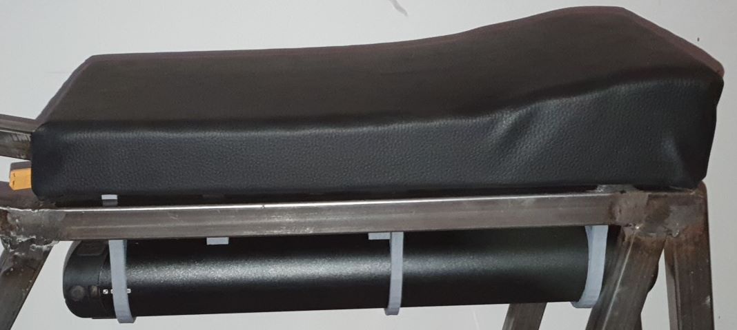

Just stapled the seat, im no saddle maker so the corners are just triangular folds, like on would see on birthday gifts, but i think it looks decent for what it is :)

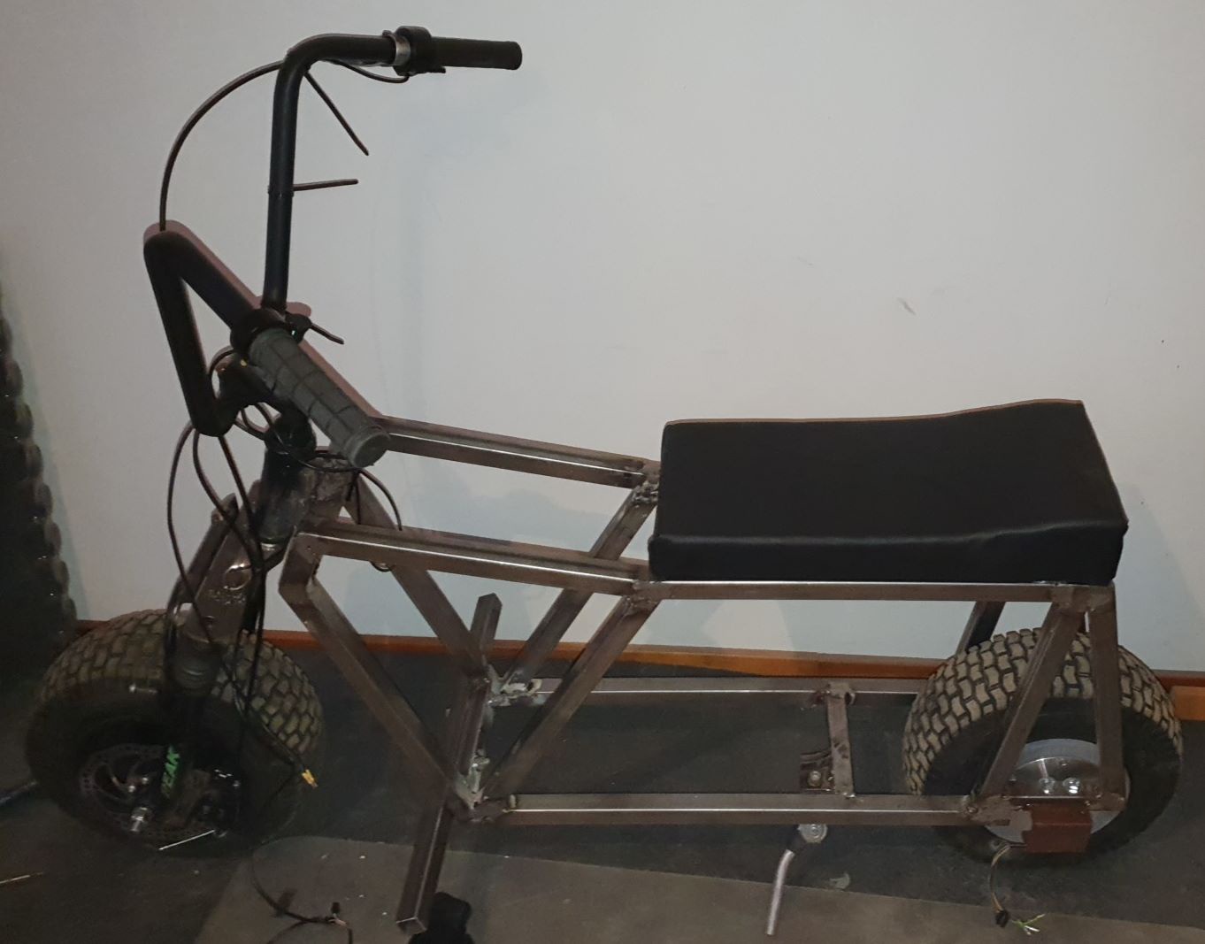

Buttoned up the foot rests and a diagonal strengthening bar to each side and brought the bike home.
Beyond a long enough brake wire, I think i have all i need on hand and will see about having a start at it.
Gonna see if im happy with how i can get controller, lights and batteries mounted or if some bracketry will be needing to be welded in.
When im sure ill take it apart and spray the thing black.
Got a wire for the front brake, installed brake level and throttle on the right, bell on the left and display down in the center.
Ive started on an under-seat mount for the controller and thinking how to mount the batteries.
Heres how it looks now:

Your front rotor is mounted backwards. A directional disc rotor must be mounted such that the rotor spokes are in compression under braking. This is just another example that proves my original point that you shouldn’t be jury-rigging parts on a vehicle that will be sharing roads with full size motor vehicles unless you know what you’re doing. That rotor has an arrow that I can’t see, but I know it is backwards because I understand this stuff; actually the arrow is printed on the other side because it is mounted backwards.
I have seen these minibike/bicycle directional rotors come apart when mounted backwards like this on an EV. Fortunately it was the rear for that guy but it could have ended far worse if it was a front like yours.
I have wondered about this for a while, and surprisingly enough, while you're likely right, it doesn't have to be the case.
From the perhaps best paper on the matter:
Existing rotors are meant to be loaded in one direction only. The direction of rotation is inscribed on each rotor. However, optimization results in Figures6.3 and 6.4 show tiller patterns that are opposite the expected tiller pattern direction. To investigate how important it is to load the rotor in the correct direction, stress analysis on Rotor B under reverse loading was conducted. Figures 7.5 and7.6 show the stress distribution in the rotor under normal and reverse loadings.There is little change in the stress distributions except that the tensile stresses become compressive stresses and compressive stresses become tensile stresses of the same magnitude even when the rotor is in the loose screw condition (except areas around the mounting holes). Although this analysis and the optimization solutions suggests that the direction of rotation of the rotor is not important, additional buckling analysis is necessary to understand why one direction is preferred over the other.
Of course I’m right. You can look anywhere else and find it to be true. Directional motorcycle wheels will have spokes trailing to be under compression during braking. A directional rear sprocket will have spokes trailing to be under compression for the heavier driving force. And directional rotors will have spokes leading to be in compression. Part failure is far more predictable than with tension.
Here is a product shot for the rotor ive got.
Did some reading around and its seems there are rotors marked differently due to varying ideas/opinions of manufacturers, as well as differing by design, so ill just go with the direction printed on the thing.
Also, since your posts are mostly know-it-all put-downs, id like to officially inform you that you very welcome to bow out of this thread permanently. Either way ive put an ignore on you and i wont be seeing whatever further put-downs you still feel like making.
Finished up printing the three battery mounts, here is how they clip in under the seat, together with the controller:
And this is the view with the seat on, but not tightened down, it will be clamping in the mounts when tight:
I realized that i wont be needing a backstop due to the batteries widening up by the front end, still need to figure out something to keep them from sliding forward tho but that ought to be simple enough.
I will also be adding bottoms and sides to turn the coutouts to the side of the controller into an enclosed compartment for the wires.
Ive ordered a 12v stepdown which will also live in there for powering the lights separate from the controllers due to not being able to figure out if it would be safe to power the lights from the light wire on the controller or if that is just intended for use as trigger voltage for a fet.
Those holders look a bit thin to be honest. In the sun, with the battery inside, it's plausible they will heat up to 50C or more, and at that point the weight battery combined with the softening plastic might make it sag considerably, over time.
I'm especially concerned with the tabs resting on the frame, the circular parts will likely be okay.
