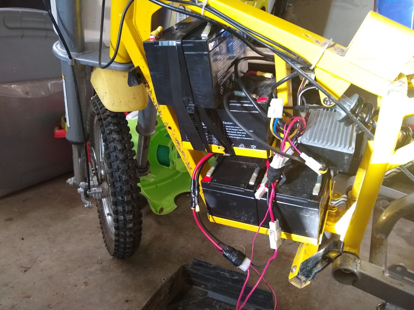

Batteries mounted and wired with 10ga.
Soldered the charging plug directly to the battery. Bought a cheap 48v charger and going to cut the end off and solder on the original plug. And what the motor shaft bearings looks like.
Ordered an lcd volt gauge as well to hopefully keep me from over discharging the batteries. At least until I get a 48v controller

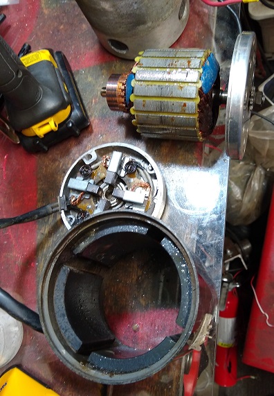

The mx has been getting slower and only lasting a mile or two vs the 10 miles they are supposed to last. So after replacing the batteries and checking the batteries multiple times I took the motor apart. And the bearing the shaft rides in was completly rusted. So cleaned up the motor with a scuff pad and starting fluid and order new bearings.
Took off the dust shields on the new bearing and packed with quality high temp grease. (seems to make these cheap Chinese bearings last longer)

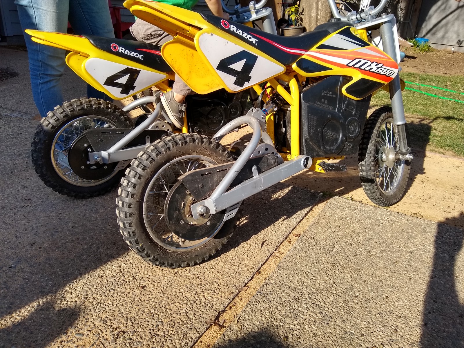

Picture is of a 100% stock one and the one I just finished. You can see the height difference by comparing the rear fender height off the back tire.
