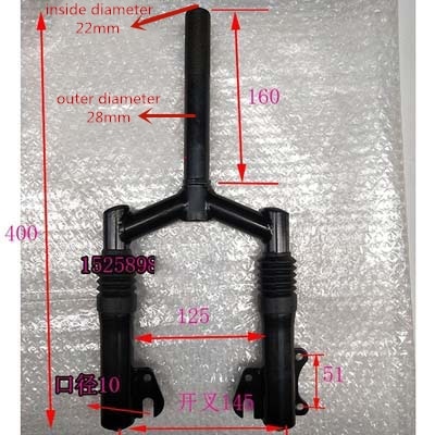

I might do the tensioner sooner rather than later but I'm saving the headset to see if I want to upgrade the fork. If yes, I'll have a new headset ready for it. If no, I'll have new bearings if the headset feels too gritty.

I found what could be the fork for you. Looks more solid than the stock, has a shock and takes a disc brake. I don't know if al the frames are the same but mine need a long neck, you can figure out if this will fit yours.

That does look interesting. They don't list rake and I'm not sure if it is threaded or thread less. I see combos that have the fork, a motorized wheel, a disk brake and a fender but I can't seem to find the fender separate. I would need to do a wheel upgrade too.

Well, I've heard too much disagreement on what the rake really is, according to some you don't know the rake until you have it on the frame. it looks like the offset is about an inch. I haven't bothered to look at one of mine to see the stock offset or rake.
With a higher achievable top speed, more stability would be desirable so rake greater than stock would be ideal.
