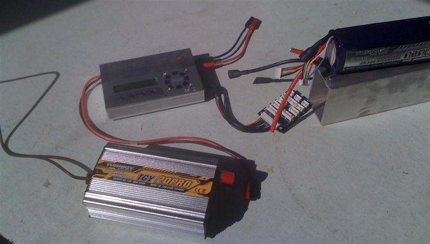

It appears that most or all lithium RC batteries, whether Turnigy or Zippy or another brand, are sold with +/- electrical leads and a multi-wire balancing information lead (which I presume carries information on cell voltage). To the best of my understanding, all the smarts of balanced battery recharging are held in the external charger (e.g. the 1010B), which receives its power from a DC power source (an AC or DC converter usually), and then connects to the battery(ies) via recharge cables and balance info wires a la:
But this makes for a very messy recharge environment.

The key is sthe difference in chemistry. AllCell is LiMn or LiNi chemistry not Hobby Lipo and should inherently be safer. Using the hobby batteries like from Hobby King is much more of a fire risk. Enclosing them in a sealed box is also not a good move as they could explode like a pipe bomb. You really need to do some research if this is for resale and do what all of the "good" suppliers do like ebikes.ca and efikessf and others. Stay away from LiCo like hobby batteries. They have wonderful properties but safety is not one of them. How about A123 20 ah cells combined with agniusm's kits for hand assembly. No safety problems there.
