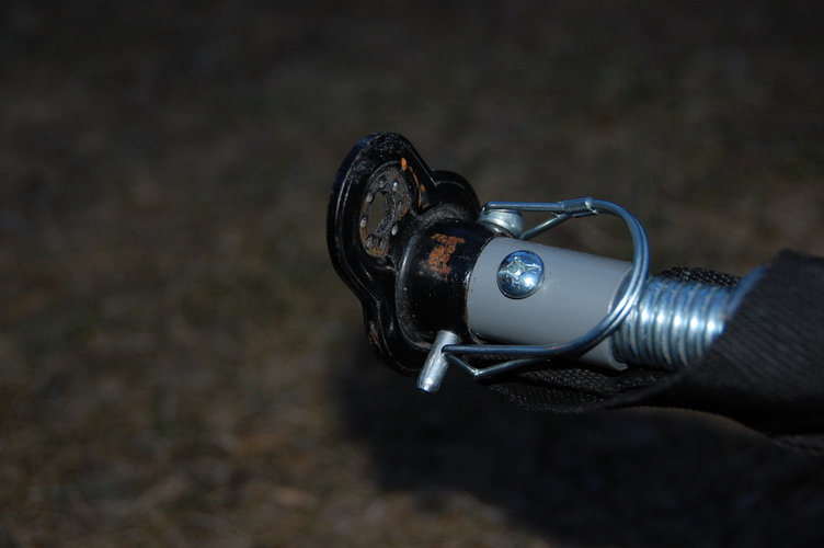

Might be a good idea to choose a strong "hitch" mechanism to connect the trailer to the bike. I've seen three types:
1. Friction fit with a clamp over a frame tube, e.g. Bell trailers. Seems like the least good solution to me.
2. Ball hitch, e.g. Chariot. Promising idea, but with a plastic ball the strength might be questionable.
3. Receiver tube, e.g. MEC and Schwinn. The receiver plate bolts rigidly to the rear dropout and the tube part on the trailer is fixed with a hitch pin just like on a car receiver hitch. Looks the strongest to me. MEC uses a clumsy solid square iron, while Schwinn uses a lightweight tube. I'm hoping to transfer the Schwinn hitch to use on my (lighter/nicer) Bell trailer.

Here is the friction fit which clamps over a frame tube, as originally on the Bell trailer. I rode with this for a while, but is seems like the least good solution to me. The clamp is clumsy. I had to put it relatively far forward on the lower frame stay, and if it slides backwards it will interfere with the hub motor:
Some trailer has a receiver tube type hitch, e.g. MEC and Schwinn. The receiver plate bolts rigidly to the rear dropout and the tube part on the trailer is fixed with a hitch pin just like on a car receiver hitch. Looks the strongest to me. MEC uses a clumsy solid square iron, while Schwinn uses a lightweight tube. I transfered the Schwinn hitch to use on my (lighter/nicer) Bell trailer.
