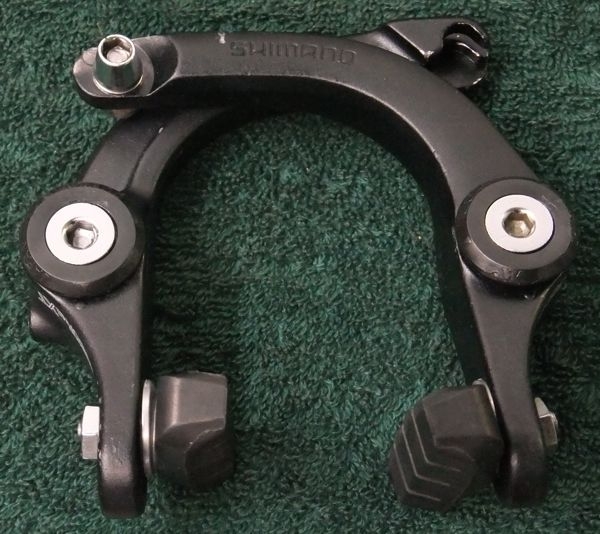

The U-brake I used most was this one, Shimano Deore XT without a booster. It kicked ass.:
My favorite U-brake in retrospect is the Campagnolo Euclid. I put one of these on my wife's chopper back in the day:
Here's an adapter plate for a V-brake or cantilever:
FWIW, I had a Fat Chance MTB with Shimano "U" brake and still have a custom MTB with Scott "U" brake; no problem with the performance of either.
