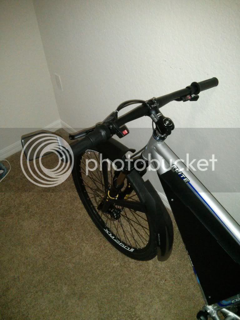

Would an 18650 or something fit down most bars? I would have two such mirrors if they were also lights.
I'm already at 630mm wide. That's both grips and brake pulls. Wider than the barriers on national cycle route's. I would look like a car coming.
It depends on the bars. They range about 22mm down to 15mm I believe.
18650 might fit in some, but 14500 will fit in even more.

How exactly do those mount inside the bar? Is there a two piece expansion type barrel that wedges into the bar end? Do you know where to get spacers for use in a 7/8" diameter bar?
You can also use moped or motorcycle mirrors on most bicycle handlebars, by using an old seatpost clamp. I have pics and some details about that in my Dayglo Avenger and CrazyBike2 threads (the DGA thread is shorter and should be easier to find it in).
