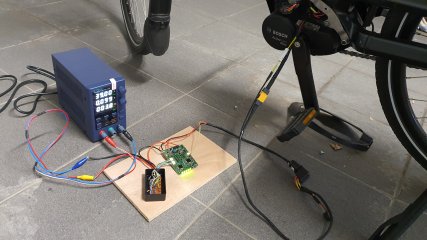

It is long time ago i played with it but i used those BMS without cells (for safety) when playing with the board trying to set battery output open so it could be used as powerbank. (it does work but i never used it as powerbank, it was just for the fun of it).
The picture below is a Powerpack rack 400 BMS without cells (powered by power supply) connected to my bike, which had no problem starting from this old 400 BMS while my original battery (disconnected) in the frame is powertube 500.
