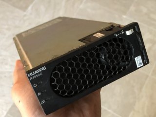

Hi all.
I have a 4850G2 here and working. (Programmed via CAN for my voltage and current, which is 54.6 volts and 20 amps.) However I notice that on startup it initially goes to maximum current (~26 amps at 120VAC in) before it backs off to 20 amps after about one second. I am worried that if I connect to 240 volts it will go to 56 amps and fry wiring and batteries.
Has anyone else seen this? Any ways around it? I could build some gadget to gradually ramp voltage up to 54.6 volts over 10 seconds or something but that seems like a lot of work.
JackFlorey said:
Hi all.
The R4850G2 generally overshoots by 5A, it's completely normal. If you disconnect the load and then immediately reconnect it the overshoot decreases. I first thought that it was the output capacitor voltage but it is always by 5A so obviously that isn't the reason. As long as the load is not too sensitive or fused I don't think it is a problem. Maybe someone with more experience can explain exactly why it does this?

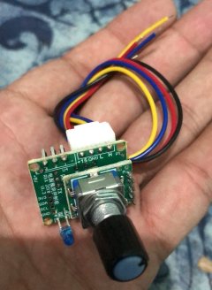

HI everyone, just made an account, you guys discussed everything very nicely. thank you
I purchased few power supplies (Used ones at 14~15$ each) , searching on YouTube, I found one guy made induction heater power supply with this same power supply and then on google search I came here.
For voltage adjustment and current limit, I purchased that CANbus module from taobao via parcelup (Taobao FOCUS becomes Parcel Up) by following the same process which was shown in YouTube video. and received it in 10 days in Pakistan. total cost 37.4$ for 1 module (psu was 14$ and module 37$ lol)
to connect CAN module and power switch, I added 6 pin JST connector on the free space of PSU.

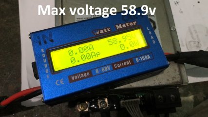

Voltage adjustment and current limit tested with module. I have noticed few things, one is that PSU works best between 50-55v, other then that, at any voltage PSU fan spins really fast, i don't know why. (without any load)
