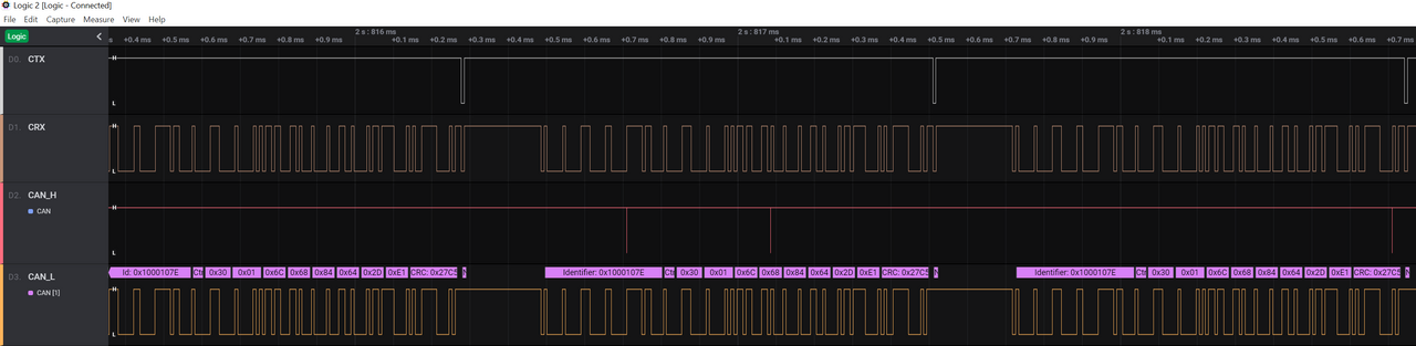

Logic analyser hooked up to CTX, CRX, canH and canL, can_H looks bad? it should be an inverted copy of can_L?
Let me guess, you have a SN65HVD230 from Aliexpress or ebay?
I have seen counterfeit parts behaving like above. What does the IC look like - does it have a poor molding and engraving like below?
It could be but the package and etching look good. I poked it with the meter, its showing 30k R to ground on pin 8, which puts it in slope control mode. I couldnt measure any voltage on pin 5 Vref, it should be half Vcc.

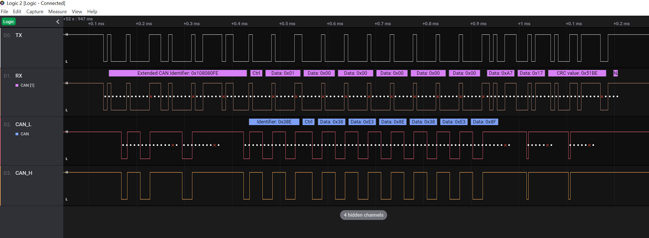

No luck with the TJA1050, the esp32 reads nothing from it while atleast the vp230 can recieve.
I plugged the VP230 back in and programmed the CAN Reciever example, which comes with the lib. With logic analyser I can see the r4850g2 is sending constant packets, but the esp32 will only pick up the first 500ms worth after a reset.
Have I got bad esp32's?

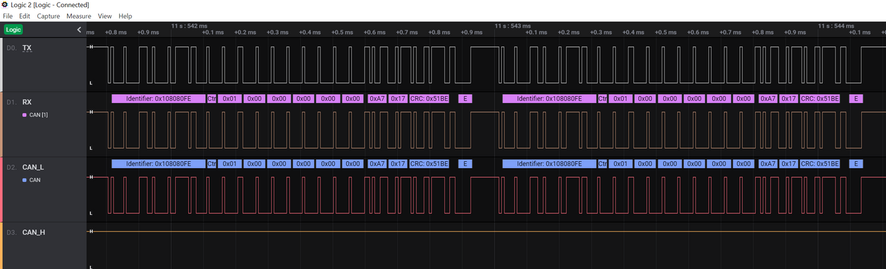

Anyway I have some progress, I put the SetVoltage(42,false) call into the main loop. I put the VP230 back in, and tried the logic without the psu connected. Now it was trying to transmit and TX looks correct, but the CAN side is wrong.
I wanted to try 5v but didnt want to kill this chip (even if the datasheet says 6v max) so I put the TJA1050 in, I put a 1k/2k R divider on RX and gave the CAN 5v Vcc, which gave me this working output.
edit: The output is now correct, my changes must have messed something up.
