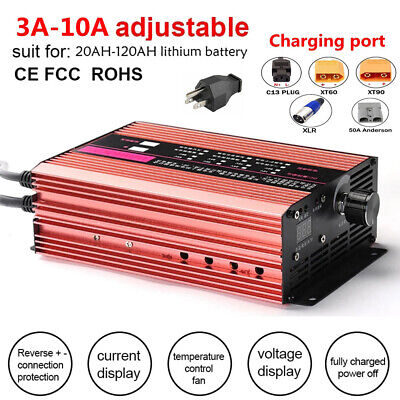

Hi !
have a charger with a potentiometer for changing the current when charging from 0 to 12 A since a year was working well
But since yesterday it fail me....when I want to charge my battery it only want charge at 20A 21A and the potentdont respond...I checked the potentiometer and it works well gradually form 10 to 0
FROM where come the failure? How can I fix it...seems strange since normally this charger don't charge more than 12 A how can it get to 20A now
I guess probably cause of the vibration of my moto when I put in the seat....

I don't think is the fuse ? Because my charger works and it's charging well ist just I can't regulate well anymore
Well now the potentiometer works I don't know what I did....but it's range is like 3amp to 15amp when it should be 0 to 12 Amp...
It like dcalibrated...maybe something is moving or not making connections properly...but I don't know where exactly

Yesterday somehow it started to work again between 3 to 12 Amp...almost like normal because normally the minimum can be set a 0
But today again started to act crazy ...give me 20amp real From the Jk app and my bms just turn off the battery for protecting
Impossible to set it down the potentiometer don't respond but it works on a multimeter
Did nothing since yesterday don't know why it changed by itself?

Were is the parameter switch?
I only found a blue with a tiny potentiometer but this calibrate only which voltage the charger stop to charge
Be careful turning the blue parameter with the brass screw I've turned them before and I turn it too much and I blew a charger. The one I did was for voltage.
You said you can charge at 3 amps to 15 amps is that a digital switch or do you turn it like a knob with your finger ?.
Is the knob that's black you turn it to the right it increases average
Talk to text figured oute turn it down it decrease ampage.

I turned it just a little and my charger stopped to charge and the green light show full charge when i was at 79v so guess is just for set up the limit voltage
The potentiometer for regilate the current is black knob normally it do the job between 0 and 12amp but since yesterday it was between 3 to 12 or 15amp depend...the Amp on the ampmeter kind of cycle and dont really stay fix like circling 3.9 toto 4,1 to 4.2 for example ...normally should not do that
And sometime got crazy and stuck to 20amp qnd i cannot lower it with the knob
