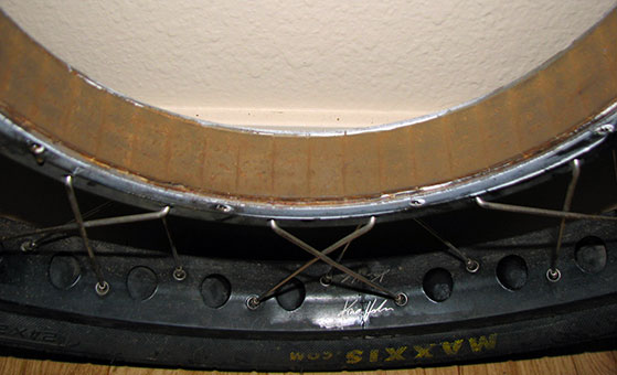

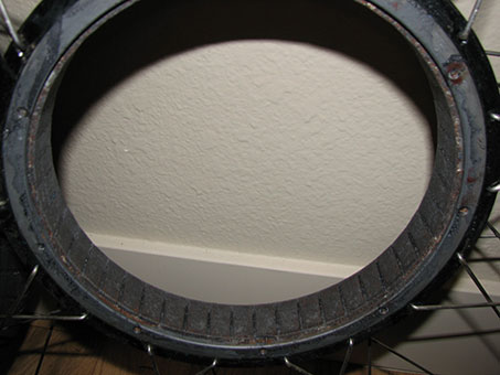

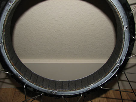

These are the rotors after one Rust-Mort treatment.
Original rusty buggers
After the Vinegar treatment
FH: After one Rust-Mort treatment
FH: full view.
RH: It’s pretty much the same shape; incrementally better and needing another dose.
There’s still a long ways to go. The stators are not that much improved since the last time; you’d hardly notice between the two coats if I took a picture of it, so I’ll wait till the end before I go and varnish it all.
Rotors: The part that worries me a little is how the residue has migrated between the magnets; I should probably get a toothpick or hard plastic bit in there and try to scrap that out. Rotors could definitely take one more treatment. Stators need one more fer sure, and that might be it; nearly done. :)
Cheers, KF
We’ve had snow for a week. Yesterday it began to melt; there’s still a lot on the ground in the form of wet mashed-potatoes. Today the weatherman says it got to 42°F. That’s good enough for me. :D
I spent the last 90 minutes outside cleaning the scale off using a stainless steel snipped spoke-end that had a nice sharp edge to it cos it’s not attracted to the magnets. Did a reasonable job. Pooped out though from scrubbing away removing black scale and acid deposits. Hands were cold and stiff and I thought about calling it a day, but – I really what to finish this, so I applied yet another coat to both rotors and stators. This might be the last round; it’s looking very good with only a couple of spots of rusty patina left.
Tapped off the excess out in the drive; the melt will wash it away. I think it’s plenty aerated; the acid out-gasses most went reacting, and that part is done. Waited about 15 minutes and brought it in whilst still a bit wet for it to finish up and dry. I’ve had the heater going full bore all week, so the humidity is very low; should dry out in no time. But I have to say: Even at 42°F, this Rust-Mort stuff reacts right away; you can see the change in the metal within 30 seconds.

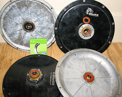

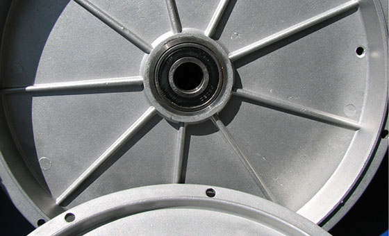

Last week I took the hub covers down to a motorcycle shop a few blocks away from my client; they said it would be no problem to the work:
  • Pull out the old seals
  • Replace the rusty bearings
  • And ventilate the covers with 3 holes equidistant at 1/8th inch diameter.
Took two days, and about $110 for labor after tax. I spaced and only had one set of seals, so the second set was ordered Monday morning before dawn on the west coast to a company on the east coast. Service this time was pdq: The package arrived this afternoon! Here’s the pic:
The black bearings are a little stiff; smooth but with resistance. Not terribly worried. The brick-red bearings are silky smooth and rotate freely. The seals pressed in without much trouble; I didn’t have a mallet though was able to tap them in using the plastic-end of the screwdriver and a hammer. Good to go.
One last slap of Rust-Mort on the steel parts of the covers and that will be that. Stators need one slap as well, but before I can do that, I need to upgrade the phase wiring on the rear hub.
One small step for man, KF

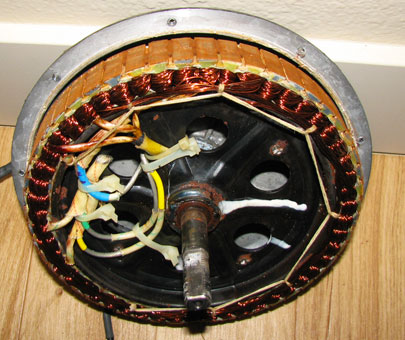

Status as of yesterday:

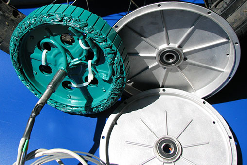

Repairs were idled but I finally got on the stick and started wrapping things up. The weather since July 4th had become noticeably warmer and stayed in the mid-70s for days since. I been waiting for this so I could varnish the parts.
Since sitting for so long, both stators picked up a tiny bit more oxidation; I hate to say rust – though it was discoloration from the humidity. Bought a small wire wheel and cleaned them all up bright and spiffy.

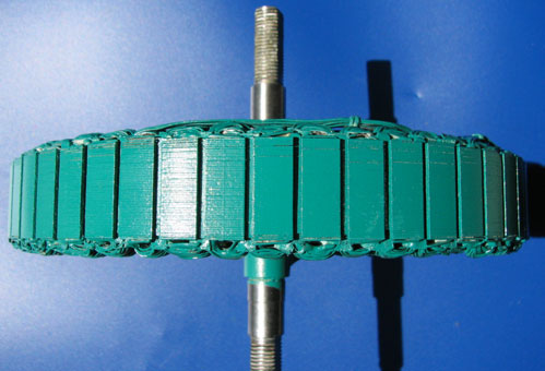

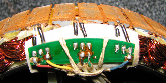

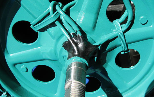

Front Stator

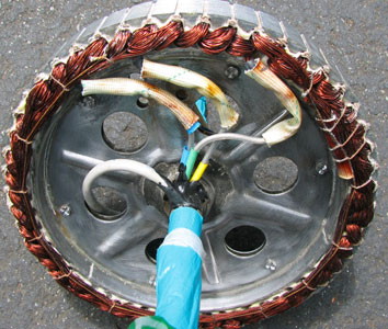

Rear Stator - taped and ready to go. Used Liquid Tape to seal the HE solder joints at the lower-right.

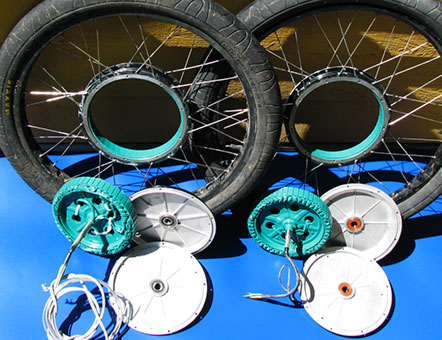

Parallel to all this, I took the hub covers over to a local mechanic that does R&R on ICE; I wagered correctly that he had a bead-blaster. Wasn’t having much fun using the wire wheel on the covers to remove the build-up, but for $50 he kindly cleaned them all up real purdy-like. Picked them up on Friday the 13th. Gave the ventilation holes a slight debur/chamfer and wiped them down with alcohol.

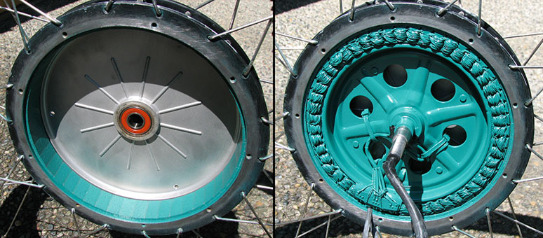

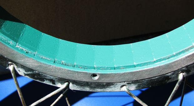

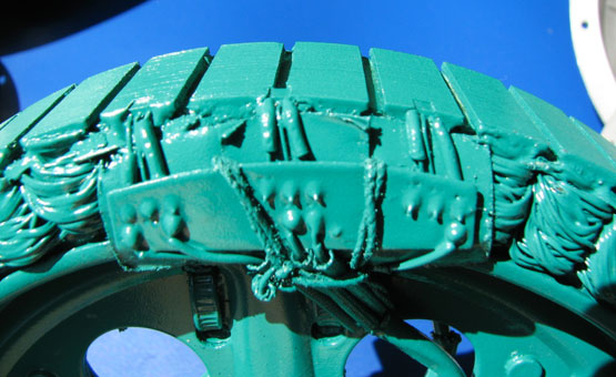

The rotors were also cleaned-up one last time and wiped down. Then spent 4 days varnishing using the same stuff as DocBass except I liked the green color better – being EV and all. Or it could have been that was the green stuff was the automotive/industrial strength… whatever. Doesn’t matter now; I’ve got the goods in hand and it worked pretty well. With varnish, spray on light layers and allow to cure, otherwise it stays tacky for a long time and is a pain to handle the parts cos yer off to the sink trying to scrub it off yer hands. PitA.
Finished Results
Closeup of Rear. This stator got the phase wire upgrade this time around. The Front already had the mod applied last year. During the 2011 road trip, the rear phase wires did become very hot. I pulled Ethernet sans outer sheath (24-AWG x 8 ) + Phase Wire (12-AWG x 3 ) through the axle which only had the stator-side exit hole cleaned out nice and smooth. It took about an hour, maybe two of cussing and swearing like a sailor to work the wires through using Teflon Grease for lube.
Here’s a close-up of the varnished rotor. Compare this to the rusty original.
Was :x
Is now :D
The Stator-side exit hole was covered over using Liquid Tape. It took several coats. When dried, if feels a little waxy like Polyethylene, but is actually quite durable. The Liquid Tape is really best for coating statically affixed connections; do not use it on wire that flexes otherwise it will crack.
The bead-blast really did a remarkable job on these hub covers! Front & Rear shown. So much better-looking than that ugly scale.
Halls on the Front Stator. The Rust-Mort really cleaned off the corrosion well for varnishing.
Top view

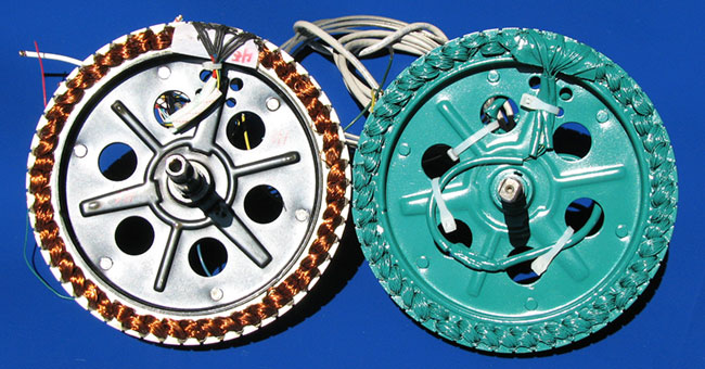

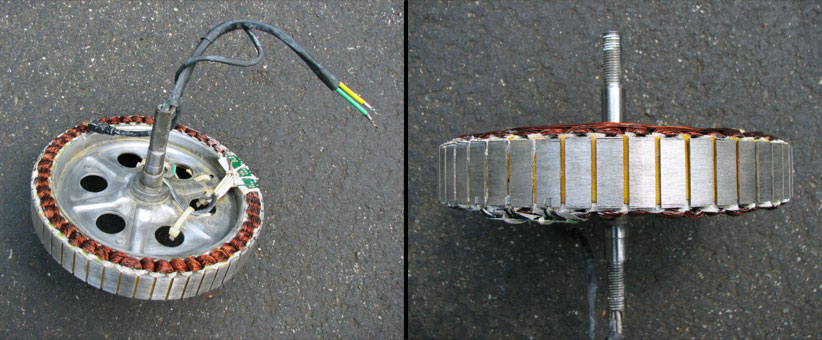

Another compare/contrast: On the left is an original never-been-used stator next to the varnished unit.
Everything is set for assembly. I can't begin to tell you how much time and money I've spent on this repair, but at least I can see a light at the end of the tunnel. More in a bit.

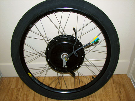

The FH has been reassembled and is on the ebike ready for a freewheel test. Without power, it spins with little effort and feels solid. I have to put together a battery pack before proceeding; briefly... the battery harness and batts were stripped for evaluation (another small project altogether).
So far so good, except that when I reassembled the RH, there was some minor rubbing. Took it apart again and the HE wires were wearing away. How could this be? I tried to bind it closer, moosh it down better, reassembled & tested – slightly better but still rubs. Anger set in and I was a bit aggressive and tore a HE wire off the sensor. Now it’s buggered good. :oops: I tried to solder it back but the solder won’t take to the wire. WTF? :evil: I finally gave up and chiseled out the HE sensors and ordered replacements yesterday from Digikey – Honeywell SS41, Qty-10… in case the FH has issues too. Anyways, those items will be here in a few days.

mouser has much better prices for the hall sensors. i paid 65 cents each for a 50 ct lot as i recall.
were they hall sensors hitting the rib on the inside of the cover? how did they get so far out? you did not remove them for this cleaning from what i recall. maybe the liquid rubber is really thick and hits the rib?
Mouser: Understood. Next time perhaps :)

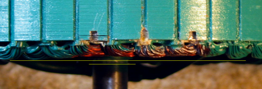

The HE sensors are buried below the circumference of the Electric Steel, and the Liquid Tape was not the problem; the heat shrink of the original construction was rubbing against the hub cover ribs where the signal wires arc over the winds. Just spinning it by hand – one could feel it rubbing pretty well, and it was unacceptable.
The only reason they could have moved away was during the rehabilitation; maybe I didn’t synch them down tight enough cos I sure thought they were quite snug. Then again maybe the dufas that engineered the hub covers for disc conversion didn’t allow for enough clearance… one can only speculate why 1 or 2 mm could make such a drastic difference. My plan could include using a 1.5 mm bronze shim to move the stator away from the cover on that side. There’s lots of room under the opposite cover so I don’t understand why the redesign was so entirely flunky. Frustrating. :x
I also considered that the hub covers are mixed up though I can’t see how that could be: It’s the only threaded (freewheel) side I have, and the wiring has to exit on the other end. Again – frustrating.

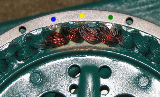

Color of each phase denoted above empty HE slot.
Now that the sensors are removed, it left the winds exposed and I was able to lightly tamp them down about 1 mm more which combined with the bronze shim should improve the odds of success. From the top yellow line, you can see that I’ve mooshed the phase wires down a bit more than the average winding height. The second shorter yellow line is where the bearing will sit against the stator axle: Not a whole heck of a lot of room to work with.
Windings mooshed down a bit to allow for clearance of the HE signal wires.

Reversed the rotor on the RH and gained 5-6mm of tire clearance; good to go. However now there is some very slight rubbing inside the motor. Mounted it anyway just to get an idea, and it runs forward kinda rough like a throaty rumble. It could be that the phase and Halls are off, but given that the FH wiring has not changed and it too runs at half speed, I am not certain this repair went well.

Went through my photos of the motors just before and during rework and confirmed that I managed the wiring correctly inside the motors for both HE and Phase coloring. In addition, I was able to confirm that the color codes for FH and RH are different, and therefore must continue to be expressed that way at the connectors.
  • The FH, A->C is Y G B.
  • The RH A->C is B Y G.
  • The Controllers A->C are: Ebikes Y B G/Lyen Y G B
  • The Controller-side of the Phase Connector is expressed as A-B-C for both controllers, and using the Ebikes coloring convention of Y B G.
The Pictures tell the truth...
FH Phase = Y G B.
FH HE wires are also Y G B.
FH at the connector is Y B G (A C B); I don't know what the Halls are without tearing into it.
RH HE wires = B Y G. What a mess...
RH (nice and spiffy before varnish) Phase = B Y G (it's a little deceptive as the Yellow wire snakes back in place).

Yesterday I was finally able to test these motors out. I believe we can conclude this thread by stating that the Test was very acceptable and that the motors performed better than expected. There’s a pesky high-pitched singing/whine in them but I am nearly certain this is due to the disc brake. Beyond that, I am really quite relieved the rework executed well. Time… and Old Man Winter will tell if the R&R holds up. If there are no more issues to report, I should like to post again on their performance in the Spring.
Many thanks to the contributors that helped me complete this project.
Adieu & safe travels, KF 8)
