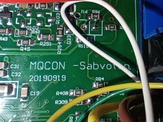

Connected Sabvaton SVMC 72150 with S830 Display. Error 10. ( Temp Sensor Problem )

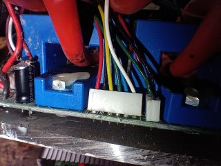

The Sabvaton i now have has the old school, white bulky Hall sensor plug, we all know the one BUT...
it has 5 wires. NO WHITE WIRE.
Where would i find the Temp Wire..??
Usually White and the 6th wire on the Hall Sensor Plug. Correct??
Not there. Hall sensor plug has 5 pins/6 holes
So i go to my old Sabvaton SVMC 72150 and see that the Hall Sensor Plug have 6 wires.

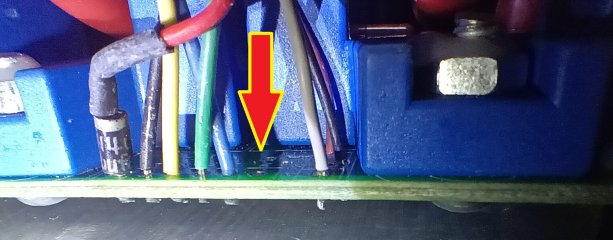

Inside on the PCB Board there are 6 wires from the board.
I open up the New Sabvaton and in the same spot there are 5 wires and an empty Nos 6 hole. PCB Board numbers are identical.
Whats the story here??
Was this controller made on a Friday at 4:55pm.. just before the bell??
How can i bypass or clear the ERROR 10 on the S830?
Do i solder a white wire into Hole Nos 6 next to the 5 Hall Sensor Wires on the Board..??
