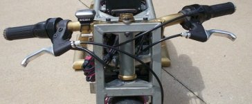

5' 11" Drop Test
I used some simple tape on the ends to protect them and keep the cells inside without providing much cushioning effect. Then in order to produce some randomness I rolled it off the top of my head and I'm 5' 11" tall. I repeated the test five times. I then took the cells out and found that some of the cells did show some signs of mild denting as they must have bounced against each other on one of the drops that landed more on the end.
So the test results show that the cells will begin to bend or break before the tubes will themselves break. The damage to the cells is trivial though and with springs they would auto-correct for the increased space. (I returned the cells to their original tubes and tested them and they still work fine... these ends caps were spares, so I felt it was okay to risk it with them)
This REINFORCES why the simple screw idea fails... the cells are easily dented and if you didn't have the auto-correction of springs they would get loose.
Soldered packs would not likely withstand a drop of nearly six feet... these Solderless Tubes passed without any problems.
:arrow: The Solderless Tubes passed the "Drop Test".
(this is definitely one of the more rugged pack designs)
