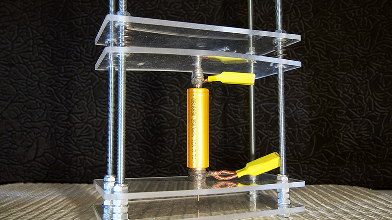

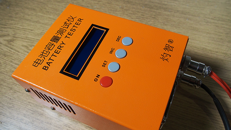

The batteries were bought from Queen Battery which is my reliable supplier of genuine cells and tested with ZKETECH EBC-A20 and a self-made battery holder. It's a PC-connected battery tester supporting 4-wire measuring and discharging at up to 20A.
50G and 48G cells were tested using my battery holder v.4.0. A detailed video about it is available on my channel.
I've followed all the prescriptions of the IEC61960-2003 standard concerning battery's capacity measurement. Before each discharging cycle the battery was charged at standard charge current mentioned in its datasheet to charge end voltage. Before each discharging or charging i've held a 1-1.5hr pause. The environment temperature was 25±2°C. To be sure in results i've done each test minimum twice (usually 3-7 times).

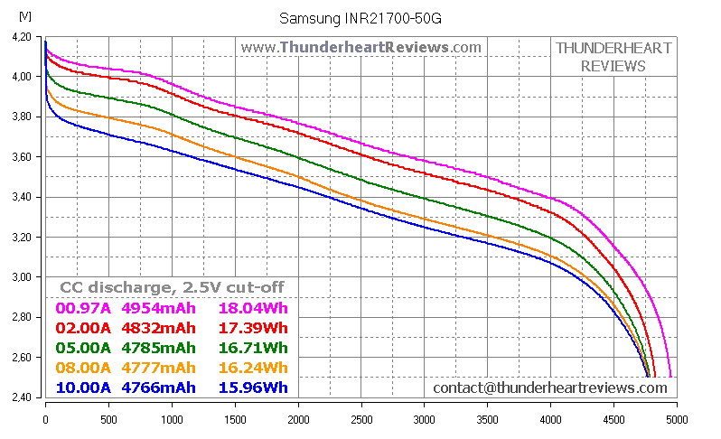

Samsung INR21700-50G battery's discharge capacity test results:
The real capacity doesn't reach 5000mAh but it's above 4750mAh even under 10A load. Curves look good.

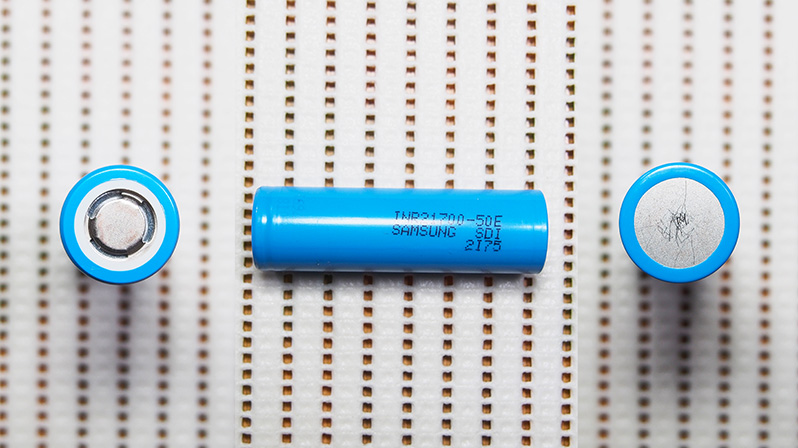

Samsung 50G vs 48G (green) vs 50E
The results of 50E i took from my tests published before. Keep in mind that it was tested using previous version of my battery holder and its standard charging current is noticeably higher than 50G's and 48G's - 2.45A.

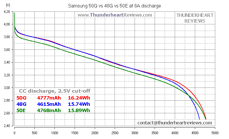

Comparison at 8A discharge current:
Here is where the 50G takes the leadership. 50E is closer to 48G - the difference in energy is only 0.15Wh.
