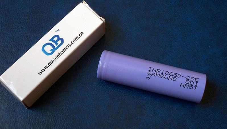

The battery was bought from my reliable supplier (Queen Battery) and tested with ZKETECH EBC-A20 and a self-made battery holder. It's a PC-connected battery tester supporting 4-wire measuring and discharging at up to 20A.

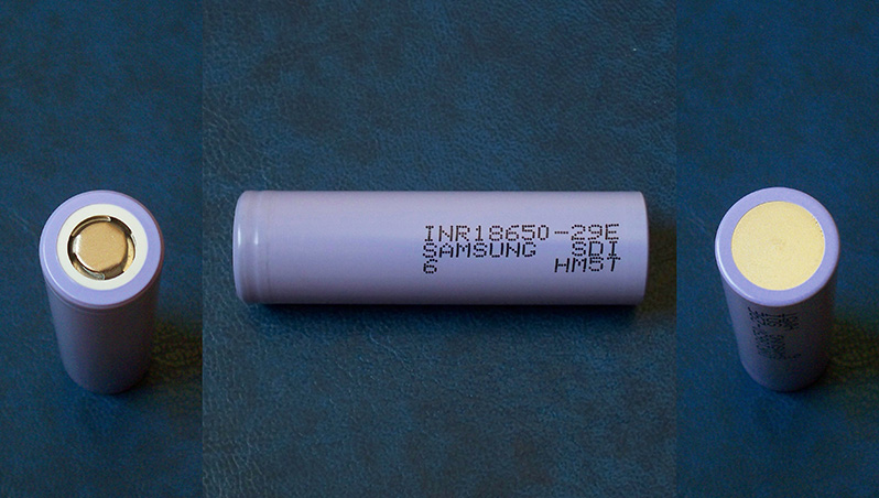

Samsung INR18650-29E v.6
The cell is marked as INR18650-29E SAMSUNG SDI 6 HM5T - number 6 stands for the version.
