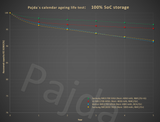

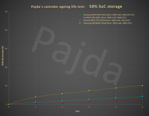

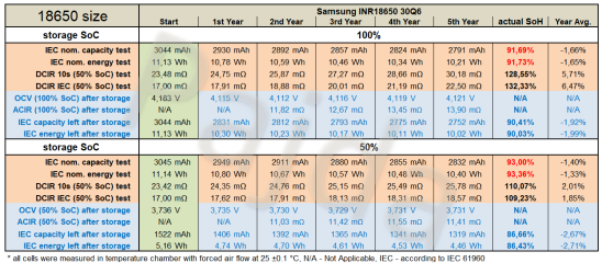

"Simple" Calendar ageing test (at nominal capacity 0.2C)
Test eqiupment:
- Precision multi-channel battery tester (accuracy ±0.02% // 10x better than ZKE testers)
- Temperature chamber with ±0.1 °C stability
- BF-2A four-wire cell fixture (20A version with Gold plated contacts)
- Cells were stored during test period in a desk drawer, in closed carton box in room with average temperature 23 ±3 °C
Remarks and comments:
- Please don't ask why this particular selection of cells (spontaneous decision? :) )

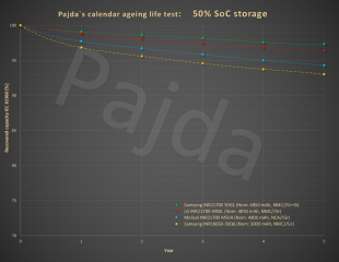

- The 50% state of charge storage value is defined by performing the standard charge method of the cell and then discharging it with a current of 0.5C for 1 hour.
- After each year of storage, there is a procedure which gives "after storage" values:
1) at first values of OCV (open circiut voltage) and ACIR 1kHz are measured.
2) then the cell is discharged with a 0.2C rate. This gives values of capacity and energy which include the sum of the effect of calendar ageing and self-discharge.
3) then a IEC 61960 nominal capacity test (0.2C discharge rate) is performed according to the manufacturer's specification (full charge and discharge). This nominal capacity test shows the effect of calendar ageing only.
4) then cell is fully charged and discharged to 50% DoD, where the both DCIR tests are performed.
- You are probably all aware that the next values will be available in a year at the earliest. 😉

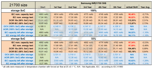

added Samsung INR18650 30Q6 to the table (Precision tester, cell supplier: ---)
added Samsung INR21700 50G to the table (Precision tester, cell supplier: NKON)

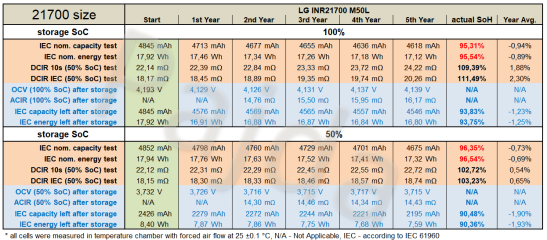

added LG INR21700-M50L to the table (Precision tester, cell supplier: NKON)

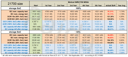

added Molicel INR21700-M50A to the table (Precision tester, cell supplier: NKON)
Losing about 1-1.5% per year at 100% vs .5-1% at 50%? Pretty negligible in my opinion,
I always thought the warnings about 100% storage were overblown. Not knowing any better, I often left my ebike pikes fully charged in my early ebiking years.

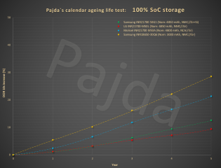

So another year has passed and I am updating data after 2 years of ageing.
Well, see you next year. :)
oh 'cmon dont leave us hanging
please Pajda a one half sentence two year non conclusive comment please?
Mike
Ed: Can we say Good? I ask You ?
Well, first of all, I have to point out my methodological error, which slightly affected the 2nd Year data. You may have noticed that the blue "after storage" capacity&energy data are a bit higher than in 1st Year. This is due to the fact that Pajda was in a hurry to go on vacation 😊 and did not leave enough time to equalize the cell temperature to 25°C in the temperature chamber. So the first step of the test: the 0.2C discharge started with a higher cell internal temperature. The rest of the data is fine because the temperature of the cell has managed to equalize during the first step.
With a certain amount of caution, I can give this assessment:
- The storage SoC level still plays a role. But, there is another parameter missing in this test and that is storage temperature. The general assumption is that with low storage temperature, the difference between storage SoC will decrease, while with higher storage temperature it will increase.
- This test also confirms the general assumption that High Power density (HP) cell design age faster than High Energy density (HE) design. This happens in both cycle and calendar aging. A phenomenon that further exacerbates the perception of faster aging of HP cell design is the increase in internal resistance. In a practical HP application, 0.2C nominal capacity is useless, you only count usable capacity at high C-rates.
