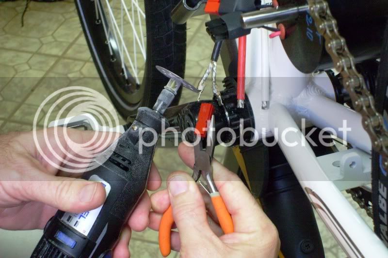

Most the soldering for connectors is done, maybe 2 weeks to its' maiden voyage. Some issues getting what must be 6ga aluminum wiring from the ESC to connect to ?18ga copper wiring of the Astro. The throttle to ESC is soldered direct without connectors.
No way the big Andersons were gonna fit on the motor wires so took Ypedals' suggestion to double up on the 45amp connectors. Took some doing as the 6ga ESC wires were too big for 2 of the small Andersons. I'd split the 6ga, tin some solder into the fray, then grind the wire down. Interesting that the solder formed a nice smooth shiny surface as I grinded. Got it fit the connectors with no loose wire ends anywhere.
(Edit note: I've realized work to be saved and better connection without the connectors; the reason for doing so now is I'm contemplating upgrading the build in 2011, different motor in possibly different location.)
Building this little Astro is motivational, had to get the hang of soldering copper. Next need to continue to learn metal fabrication, then brazing & welding, fiberglass casting and 3D drawing w/ SketchUp.

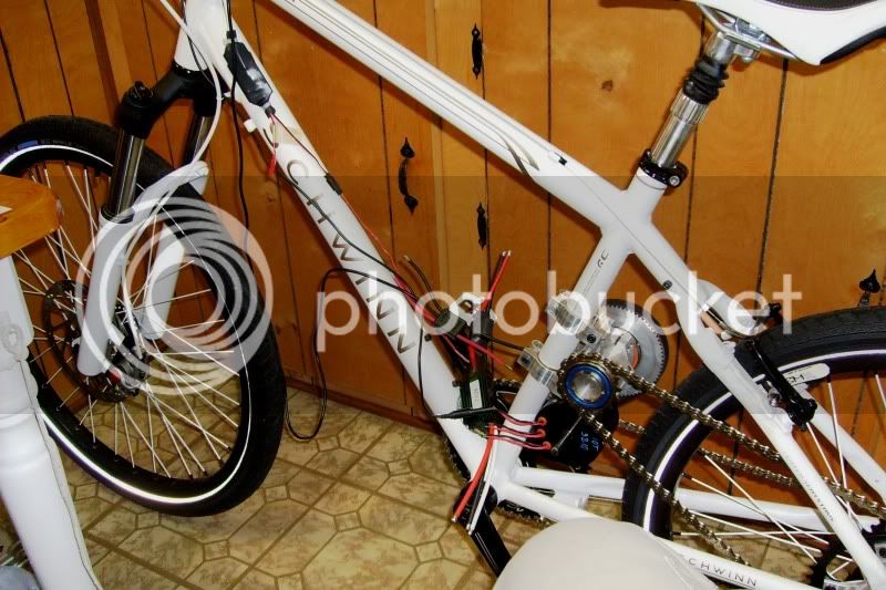

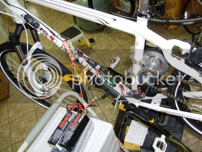

Got the batt box together, close to ready to ride up the street, however, Houston, we don't have ignition :( plugged in 12S, just 5Ahr to see if the motor would spin; Nada, nutin, ssssss ssssss sssssilence. (also tried plugging in 6S)
I'm scratching my nogin, how about those lose wires dangling from the throttle interface? If not that, where should I start to troubleshoot?
You need to supply battery voltage to the small plug that is currently unused on the throttle interface. That powers the electronics in the interface. I normally put a tag on that wire that says "6 to 60 volts input". :)

Yeah, you had labeled that connector 12V-60V, today soldered in 2 little jumper wires to the red/black of the interface to supply voltage/power, however, still lifeless :( The new lipo's showed all very similiar readings during charging, small spark when plugging, believe those to be hot. There's continuity thru the harness. My meter says it's limited to 10amps, seems it would magically smoke if I measured lipo amperag with it. Haven't spent too much time trouble shooting, but if there's good ideas as to how to go about this, please chime in :!:
Nuts, forgot about LVC, disregard the foto 1 Lipo, returned to using 2 batts, 12S
You have the ESC plugged into the throttle interface with incorrect polarity. Reverse the little 3 wire plug between the ESC and the throttle interface. That should fix it. :)
