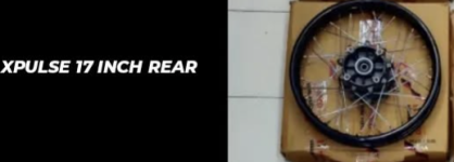

I will be mainly be using parts from a adventure bike that is very popular here in india called the Xpulse 200/210, just because I don't want to pay the excessive price of shipping rims to india (I asked and shipping alone for a rear and front was 200$ with import tax)
  • xpulse 17in spoked wheel: 49usd( One problem with this is that, the largest aftermarket rear sprocket I found was 49t)
