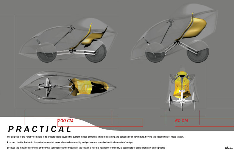

Sexy Practical Velomobile?
Here is another really nice Velo, I like the way it's set-up in the high position (this is the way I would want to ride it, on a more up-right position high enough to have eye level with the average car driver.
http://bicycledesign.net/2012/05/petal-velomobile-by-eric-birkhauser/
Not sure it's even been build however, I strongly suspect these are all just CG concepts, but I REALLY like the looks of it! 8)
Most of those won't be able to handle a stiff cross wind. Two wheels are better than 3, which means either landing gear or flywheel(s) for gyroscopic balancing at very low speeds or when stopped. You also left out passenger room, because only hermits want to be alone all the time. Most of the time I don't want to be totally enclosed either regardless of how much drag coefficient increases to avoid being in a solar oven.

Very interesting! :D
will see if I can find info on the cargo area, it's still lower than I would like though.
