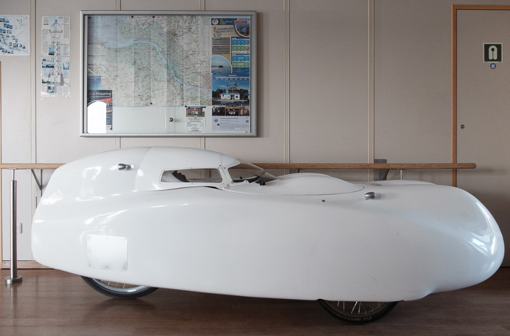

Marc S. said:The Phaserunner is set to 15A, 40A phase current and 10A field weakening. Max power is restricted to 1kW.
CAv3 with throttle, PAS, etc. Usually set to 600W max.
Acceleration is slow...ish. Consumption at 37mph is about 8-9Wh/mile (I think).
I finished it only last Monday and while I rode 584km since then, haven't tested the real world consumption yet.
Marc S. said:Its a simple cadence sensor. If I want a workout and put more force to the pedals, adding assist power as well seemed wrong to me.
Marc S. said:On the other hand (since the magnets for the cadence sensor are mounted into the chain ring) by shifting down and raising the cadence for climbing hills, or by shifting the Patterson Metropolis into its 2. gear (1:1.6 overdrive) for higher speed, the faster spinning chain ring also raises the assist power. This behavior is configurable by the Cycle Analyst and adjustable on-the-fly with the analogAUX pot. If I need more power (climbing, starting from a standstill) it has a throttle as well. I got the same setup in my trikes and it feels pretty natural.
Power draw at top speed (flat, smooth tarmac, quick tires, with hood) is around 300W electrical (including 20W for the lights). It seems like, I add about a moderate, but sustainable 120W by pedaling... (my fitness level isn't that great at the moment).
Räderwerk stated, an aerodynamically tricked-out Milan GT Mk2 with hood has a Cwa value of 0.0368: http://mission-milan.de/techspec.htm
Impressive, isn't it? On my first ride after the conversion, I could hardly believe the low consumption figures.The Toecutter said:With a 120W pedal input, you could be looking at a real-world 250+ mile range on your 1.5 kWh pack.
About 86 lbs with hood (without battery, tools, etc) and except for the small hub motor, didn't even tried to make it particularly light weight. Its an older, heavy, glas version that already weights 70.5 lbs as a pure cycle. The current carbon version starts at 55 lbs.The Toecutter said:I also am willing to bet that your conversion is around 100 lbs for the whole vehicle.
I've tried disk wheel covers on my trike a couple of years ago. The downsides (a pain to inflate the tires, even bigger pain to lock it to something, greatly reduced cooling of the drum brakes) aren't worth the small efficiency improvement. Not by a long shot.The Toecutter said:You could give a slight 1-2 percentage point reduction to energy consumption by installing wheel discs to cover your spokes. For a vehicle such as this, I think it would be worth it.

Starting with an old Milan is kind of cheating, don't you think?The Toecutter said:It is. I remember no shortage of people telling me that the low consumption figures or range I was looking for couldn't be done in a sub 100 lb vehicle. You've gone and done even better than what I was proposing.
You could not have chosen a more efficient platform to use, and it is doubtful anyone with a hobbyist budget could build a more efficient platform. The Milan can also do 100 km/h on roughly 750W.

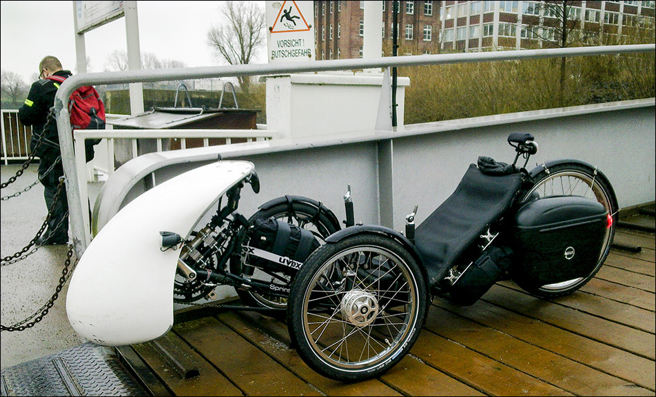

I used the disks shortly on this ICE Sprint with DD hub motor, 20s battery and 50A controller, to commute in the 'windy season':The Toecutter said:The way the wind impacts an unshelled trike and the way it impacts the Milan are going to be totally different. Aerodynamics is funny like that. The only way you'd know the impact of strong crosswinds on the operating dynamics Milan with wheel discs would be to try them. They'll either make it unstable or they won't.(I'm guessing that when you said "trike", you were referring to another vehicle besides your 3-wheeled Milan because you mentioned a nose fairing; if you've already tried them on the Milan then you know they won't work to your liking)
I live near the North Sea shore. We usually have a few Cat 1 and Cat 2 cyclones (we call them Orkan) in Autumn and Winter.The Toecutter said:My trike, with a faring and without, suffered no instability from crosswinds when adding wheel discs. I used to live in Corpus Christi, which was one of the windiest cities in the U.S. I also had a 39" front wheel track, which is far wider than that of the Milan.
