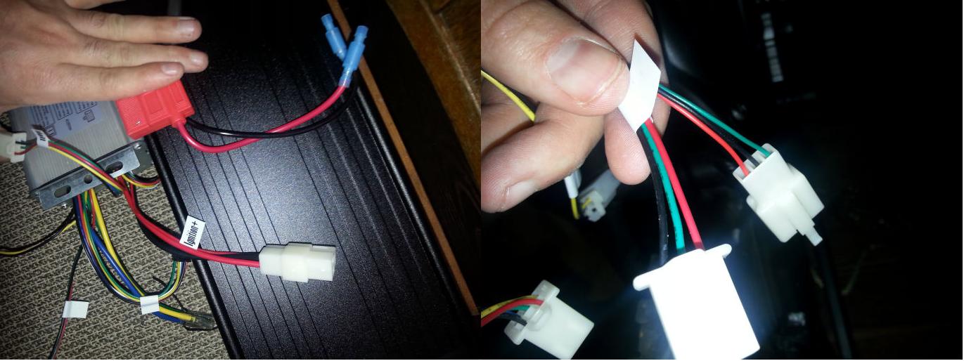

So, I am not sure of how many readers witnessed how incapably ignorant I am of battery technology when I was posting some time back about trying to build my own battery. So if you did, you probably had a good laugh and guessed I gave up on trying to build my own. In the end basically; I am inexperienced and it was far too expensive a topic for me to chance making mistakes. So I decided to buy a premade from CONHISMOTOR is Shanghai! WOOT! so around $600 bucks later, I have a very heavy very durable feeling, 48v 20ah li-ion battery sitting in front of me. I also have a Lyen programmable 12 FET 3077 Mark II Controller in front of me. SO ON TO THE QUESTIONS!
RIGHT Picture:
The wiring does not match between my GNG motor and the Lyen Controller, can i just switch the green and black wiring positions and this problem be fixed? does it matter which one i switch *controllers wires or the gng motors wires?* my instincts tell me to switch the position on either one is not going to matter as long as the wiring match to the proper color?
LEFT Picture:
There is a little red wire hanging off the Lyen power cables (red and black) that is labeled (+ignition) that is not on the battery. I am guessing this is strictly to accommodate an optional Key switch ignition? is this correct? can this just be left unplugged and taped to the side of the cables to keep it out of the way or do i need it to have some sort of positive charge through that cable in order to start the bike? Also, if it is true that I can just not use it, do I need to turn it off within the programming of the lyen controller?

You can switch the wires to make like color go to like color and you should be fine. The wires can be pulled from the back of the female connector by going from the inside and pressing the little tabs down and then giving the pins a push. Raise the tab back up and push it back into the right slot and you should be good to go.
LEFT Picture:
I think that wire will need power for the controller to power up. If your kit came with a handlebar switch then you can just have the switch go between that wire and the positive off the battery and it should turn your controller off & on.

afair you connect the little red wire to battery positive to power it on.
You need to supply power from the thick red wire on the controller to the thin red wire. This is for a remote key/kill switch and StudEbiker suggested using a handlebar on/off switch for this if you have one - since you don't appear to, just jump the wire over on the controller wiring and don't use the feature.

Exactly. Splice together, run to same battery connector.
Yes, the small red wire is also called an ignition wire. Some people wire it to a switch so you can lock your bike on or off. Your controller will not run without battery charge current hooked up to the positive of your battery.

That small red wire is for ignition, you can permanently connect it to the battery positive for a permanently on system. Connect it through an on/off switch if you want to switch the controller off when not using the bike (one advantage- if you bump the throttle the bike won't fly off- or burn a hole in your carpet like I did- if switched off), you can always disconnect the battery but the chances are you'l get arcing of the contacts and eventual damage if you go that route. Or add a key switch for a little security, others can't just switch your bike on. This switch only carries a small switching level of current, pretty much any switch will do. It seems a sensible easily implemented option, why not make use or it?
