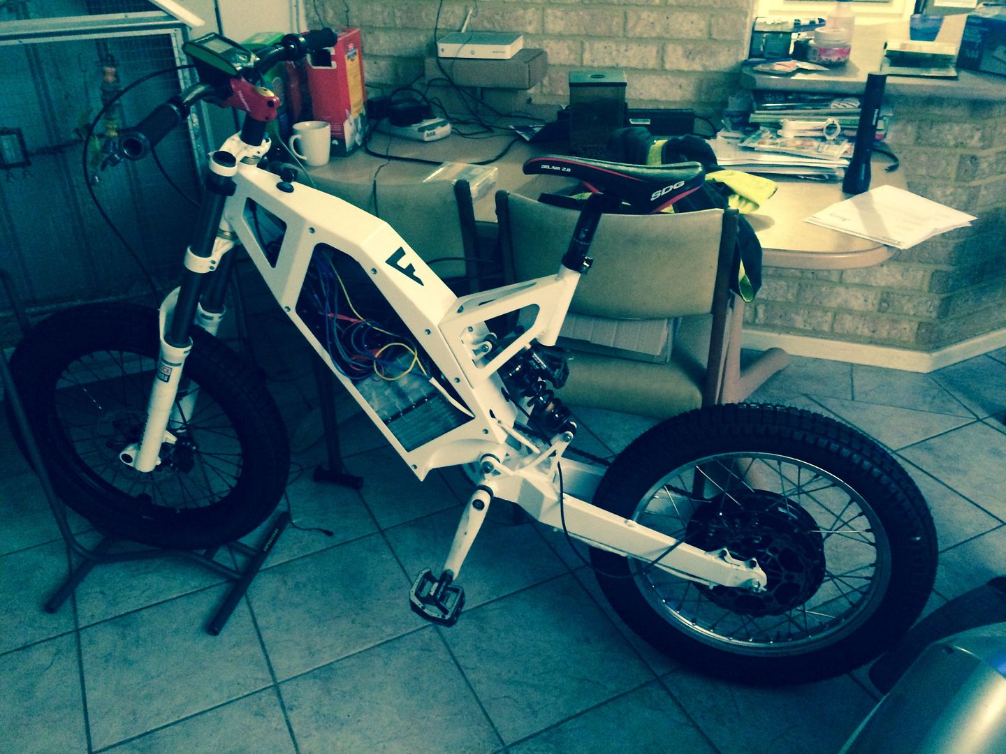

hi Cheeko,
yip, going Big Block, LHD. The battery is ready (although not maximising the BB's potential - it is 20s7p of GA cells - the battery build was already underway before I decided to get the BB).
High Voltage has set up an ASI controller to match the kit; I am just waiting for Mike (Lightning Rods) to send me back the swingarm and motor when he is complete. He has done a superb job - sourced a Hope hub, and created a very clever dual tensioner system to allow regen.

Hey CD,
In the real world, I doubt I would use the circa 5500W available very often - but if someone wanted the pack, I would be happy to explore that! Can you pm me (or post) the member's name?
