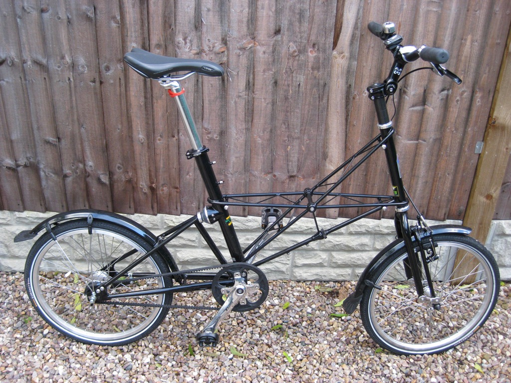

Been shopping for a F.S. bike for a winter build and found this. It looks promising.
:shock:
Jerry
He, I believe FS is really minimal on this one, but I like the idea of tensile structural application to a bike frame. I think that we should see more of this, and can have good potential for in-frame battery mount.
Its a (Alex Moulton) Moutlon TSR 2 BTW. Twenty inch wheels, a S/A S2C two speed kick back hub with back pedal brake and a belt drive. The whole thing splits in the middle with no cables to the rear.
The suspension is actually very effective with good travel on the front and a little less on the back. I am actually testing a very light assist narrow width (80mm) Tongxin motor in it. Here it is in my office with motor fitted broken in its split down state.
It's a real comfy ride.
Regards
Jerry
