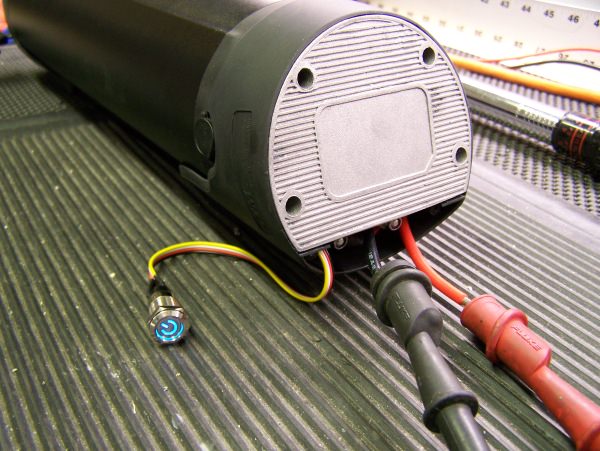

Everyone may have their own reason for it... this is what I used.
A Solid State Relay (SSR) tucked into the back end of a Bottle battery. Works great on my 1000w system with 52-volt battery.
Had it for 8 years with no issues. No contact sparking like a switch or relay contacts may have problems with. Has a nifty On/Off LED lit push switch.
Shown above during testing but eventually mounted it in my cockpit housing.
See the link for details.
1st Build & E-Bike rider-Magic Pie V5 (rear) -Bottle Batt. 52v*11.5ah-Huffy Parkside - Electricbike.com Ebike Forum
