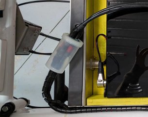

Yeah my setup currently leaves the Anderson connectors accessible. I also put them in a ghetto spray shield (the pillbox in photo). But I'd rather tuck the connectors away more securely and have only a switch exposed. Thanks for the suggested switch, I'll look it over.
