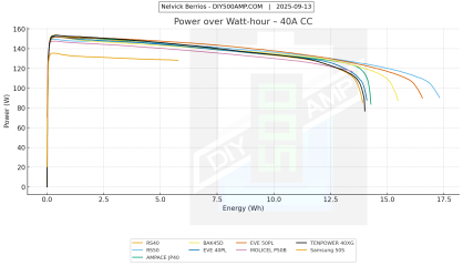

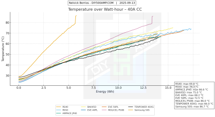

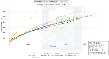

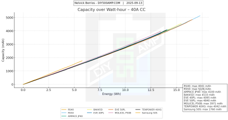

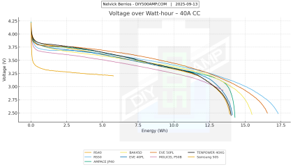

Ok this time corrected with the 40A annotation.

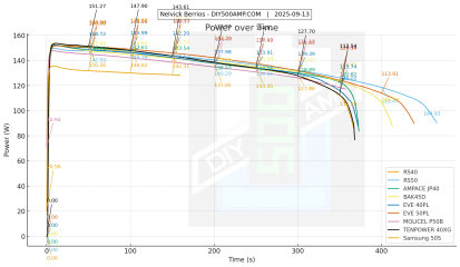

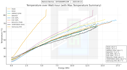

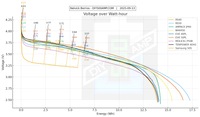

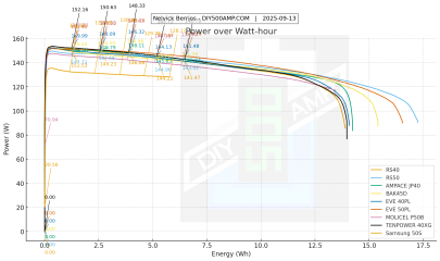

Someone has to say it: the Molicel P50B is definitely out of the game, and if Molicel want to maintain their status as a technology leader, they need to release both the P60B and M65A as soon as possible.
Btw. Great work! @ZEUS-FL
What will be interesting is the release of the M65A, P60B, P60C, XA3, 22S, 30S, and 50S all within a fairly narrow time window. I’m guessing a couple of years before the P70, P85, and the other XA Series cells though.

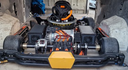

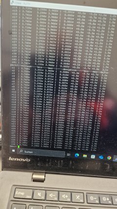

Reliance 50RS

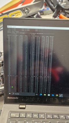

Finally, the time had come and I was able to test the 16P32S Reliance 50RS battery packs 😃 I charged the cells to an average of 4.06 V. After the first test drive on the race track (25 km) with 750 A discharge and 240 A recuperation, I noticed that the cell voltage had dropped to 3.2 V. What I noticed while observing the cells was interesting: The voltage in the 1st to 6th parallel groups increased, the voltage in the 7th to 25th parallel groups remained the same, and the voltage in the 26th to 32nd groups decreased. The whole thing looks like a pyramid. Does anyone have an explanation for this?
I can, however, praise the cells, as they never exceeded 40 degrees Celsius (air-cooled, of course) and were still able to deliver 750 A with 16P on the second test drive despite the cell voltage dropping to 2.8 V.
If anyone is interested, I can upload a short video of the race track during the second test drive.

The cells can only do so much the rest comes down to how the pack is built and balanced. Things like wiring layout, busbar design, and how the groups are connected make a big difference. Without seeing your setup, it’s tough to say what’s going on. I’d probably move this post to the pack design or troubleshooting section so you can get better feedback. Not trying to be rude, just honestly trying to help.

This is probably due to temperature deltas and other interconnect bottlenecks.
The cells in front of the cooling setup will be coolest vs the other cells, which means they have higher IR, and you know the effect of that.
The battery pack's busbars and busbars are identical between the groups. They are comparable to 40 mm² copper cables. The battery pack is connected to the control box via a 50 mm² cable. It could be that due to the different cable dimensions, the first and last parallel groups can produce more power than the others, or, as BlueSwordM suspects (the cells before the cooling structure are the coolest compared to the other cells), the first 1-6 and the last 32-26 groups are better ventilated. Thanks for your help.
I agree with your theory, as the coldest cells are from 1 to 6 and from 32 to 26. I'll reconfigure the temperature sensors during the next test to complete the process, so I can measure groups 1-32, 3-29, 6-26, 11-21, and 16-17 and determine the temperature difference. Thank you very much for your tips.
*Hypothesis.
A theory is something proven, and we haven't proven anything yet :)
I wonder if you can decrease the temperature deltas by employing preheating to around 30C before the race.
That's what Hyundai does on the Ioniq 5N on long races.

At what voltage does your BMS start balancing the cells?
Average of 4.06v can mean a wide disparity.
I'd want all parallel groups as near exactly the same voltage as possible before being worried that some P groups seemed to be sagging more than others.
32 balance cables also leaves a lot of room for Human error factor.
Would love to see video of a 32S 16P pack of RS50's delivering 750 amps to a track beast !

Balancing starts at 3 V and draws only 170 mA. I'm considering installing a 4 A active balancer as well. At the beginning of the video, I had 110 V in the battery pack. During the last lap, the cell voltage briefly dropped below 2.8 V (1-6, 26-32 parallel groups), which triggered a low-voltage alarm. After the last lap, the battery indicator shows 101 V. Unfortunately, I didn't take any photos of the cell values after the last lap.
Unfortunately, the video is too large and can't be uploaded, so I have to shorten it. I will upload the videos to my YouTube channel in the next few days so you can also see longer videos.🙂
