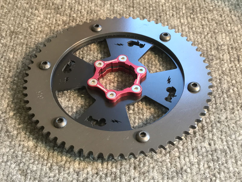

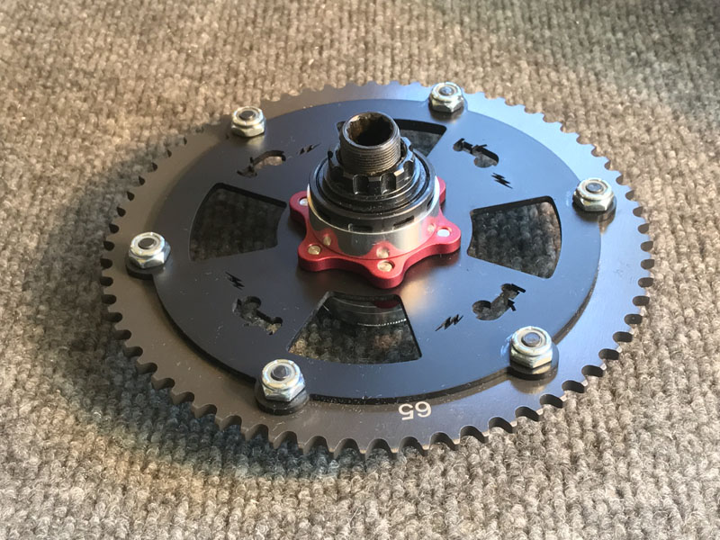

It depends on who is doing your laser cutting and what the material is. I find that stainless steel cuts the cleanest, with the least slag, followed by mild steel, with aluminum being the worst. I clean up my sprockets with an orbital sander, then hand sand (purely for looks). I bevel the teeth with a bench belt sander.

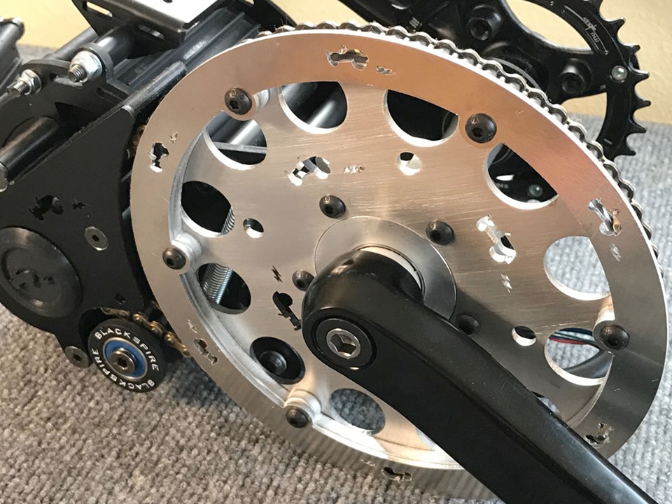

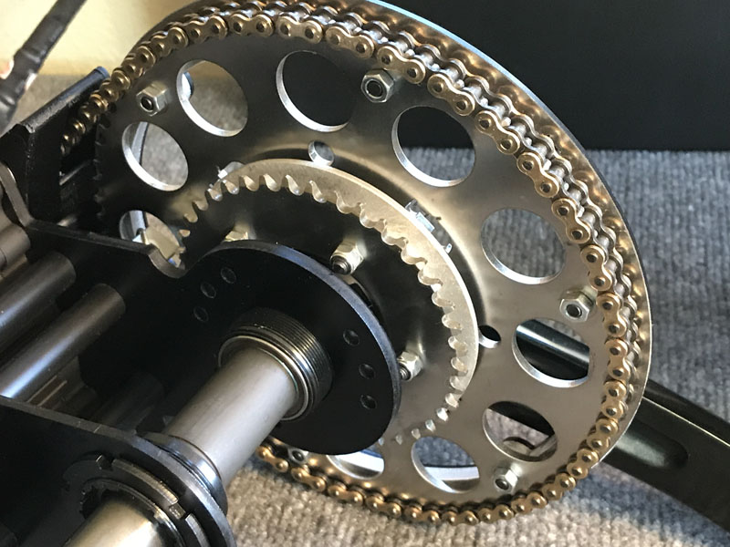

Doesn’t matter to me. On the primary stage I use a 12T #219 driver and a laser cut 75T driven for a reduction of 6.25:1. The second stage driver is either a 20T 1/2”x1/8” or a 40T #219. The rear wheel sprocket can be anything from same count as the driver to 2x for an overall reduction of 12.5:1. With a Big Block that ratio will climb a tree.

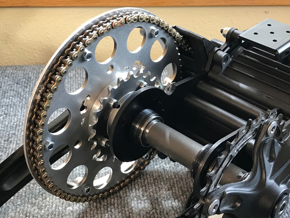

How are you coupling the primary driven to secondary driver?

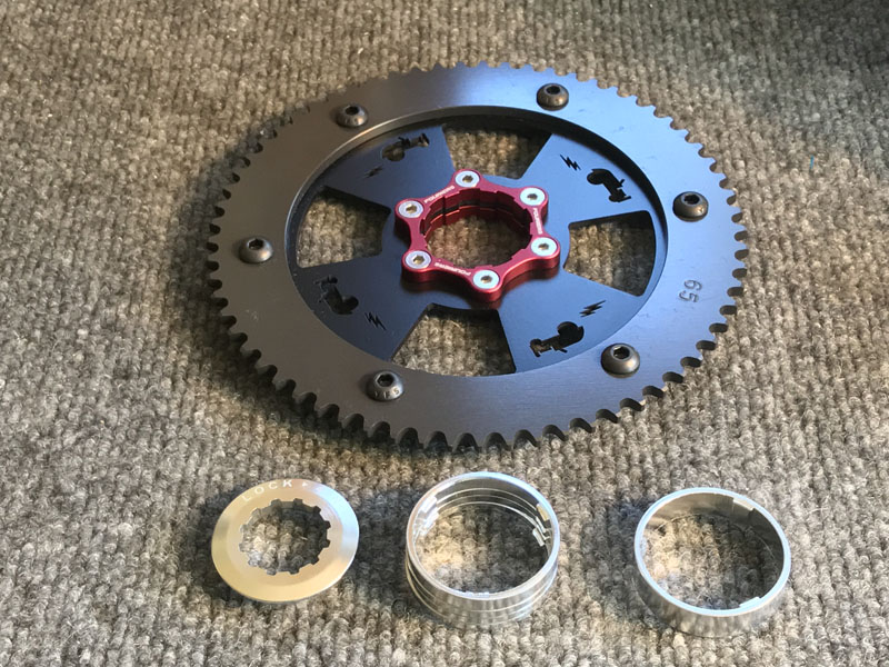

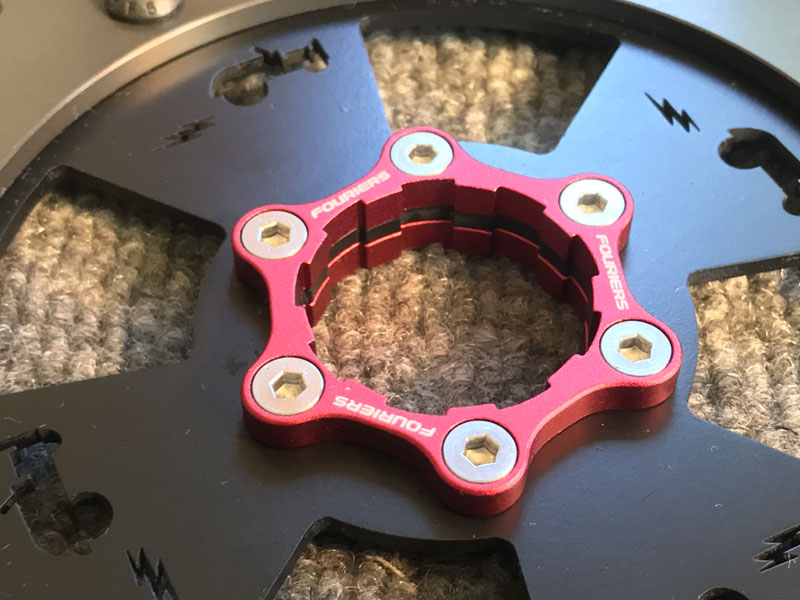

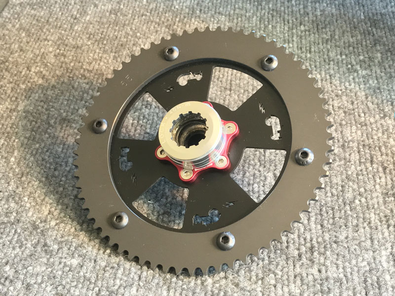

Another option is to use a freehub with one of my sprocket adapter plates. You can run either 1/2" or #219 sprockets. The Fouriers single speed conversion is inexpensive and readily available.
