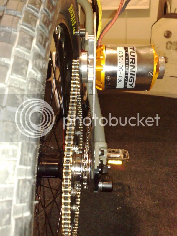

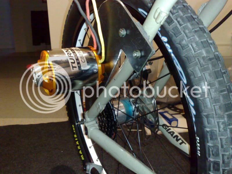

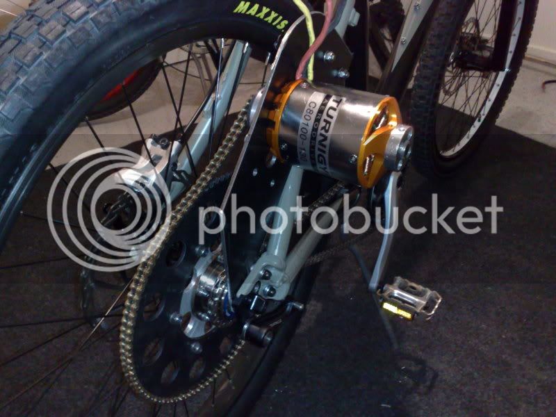

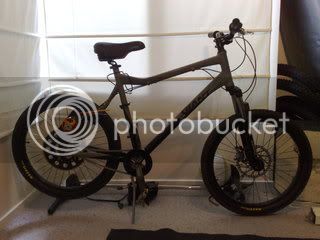

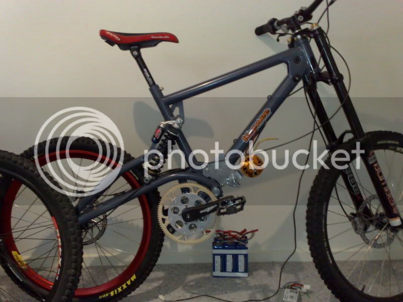

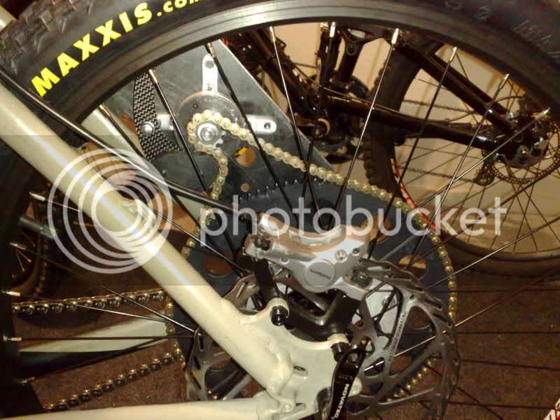

Just a few pics of how I've put Luke and Thud's great work to use. Plus big thanks to Luke's father.
gear ratio is 10:1 (100:10) using a 12s lipo the top speed should be about 62kph, though should've paid more attention to the HV110 first time out!
No time to test the new HV160 out, am on hols o/s for 6 weeks, but hope to post some more when I get back.
cheers
Brian
Nice setup! That's as good as non hub drive gets IMO. Beautiful with the #219 chain and spoke isolation setup. You even made your poor HV110 controller look like my pair of them looked after being confronted with the big HXT motor. :)
Thanks Luke, appreciate the compliment. Aimed for a clean looking install, and figured where you'd fitted your motors was the about the best place to put the big HXT.

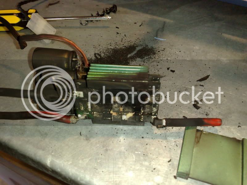

Had a few sync problems under load with the HV110 but pressed on anyway. Result was a big plasma fire ball!
Am modding a 12 fet with 3077 fets to run on the bike, but will test my luck with the HV160 in the mean time.
I push the limits of very beefed up 18fet controllers to my HXTs, and its about all they can take.
Running at a lower voltage with the 3077s with a 12fet should be fine thermally (maybe better than 18fets with 4110), but you still will have the package leg limits, so pay special care to get as much copper on the board in close proximity to the fet legs to help them stay cool, and minimize additional sources of leg heating.
Were you running additional caps on your hv110? doesn't appear so on the above pic of the blown unit.
I would be worried about cleaning the motor up on rock or a tree hanging out the side, reminds me of one of them cheap currie setups, definitely don't think its the best place to mount a motor, regardless well done on the instal you will have much better luck with a hv160 i think, wasn't able to blow mine under riding conditions.
KiM
will do Luke, have some 12 gauge solid copper wire to beef up the traces. This will be my first go at modding a controller so unsure how it will turn out.
hey Kim, you what you mean about it looking like a currie, that's what I had one my first ebike! Weighed up the downside of it hanging out the side of the bike like that versus a nice short chain and thought it was worth the trade off. I did have extra caps on the HV110, you can see two 1000uF panasonic caps above the originals and yep it worked fine on my other deeper geared bikes. The caps themselves were fine, the fets went into thermal runaway and ultimately blew the sh*t out of them.

Hi Jmy,
this is the freewheel broaching thread, so of course at the hub. What you see at the motor is an aluninium adaptor I turned up on the lathe.
I do have a SRAM DD ready to test, see below. Will give it a go once I'm back from overseas.
