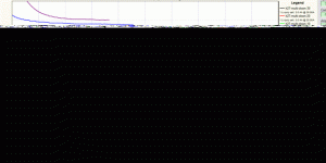

Tested one battery as ZapPat recommended, but did it with a wider range, starting at 1Amp and increasing in steps up to 30 Amps:
Higher res view here: http://www.az123.com/E-S/h29-multi_1-30A.gif
The battery tested was one of the lower-middle AH ones; 8.60AH at 8A on the first test.
Came off the charger at 3.88V. Let it sit for about 20 minutes, the battery was at 3.83V on the CBA, 3.812V on my good meter, and 3.810V at the Anderson connectors where my clamp type battery holder plugged into the CBA.
I guess the easiest way to give the results is to use the time I did things as the first element:
5:05 PM: Start test at 1A. 30 seconds into the test the CBA indicated 3.48V and the meter indicated 3.493V. The curve started to flatten in about 6 minutes, got quite flat in 10 min.
5:15PM at 1A, CBA indicated 3.31V, Meter indicated 3.307V STOP.

So, at the higher amp tests, it appears that the CBA is registering voltage quite a bit lower than reality. I think that due to the steep discharge curve, it isn't a huge difference in the actual battery capacity, but I'd guess that they are about 0.1 to 0.25 AH better than my CBA has been saying they are.... Anyone have a better estimate on that based on the info I have provided?
I finished the h29 battery off with a straight 8A test. it had 2.91AH @ 8A left after the individual step tests above. Very close to the end, I tested with the meter: CBA = 2.60V, Meter=2.638V
First of all, thanks for posting these results, RLT!
My observations using these results:
- It looks like your CBA has it's own internal resistance of about 7-8mOhms.
- Using these results it still seems that this particular cell has about a 20mOhm DC internal resistance.

OK, Here is the results of the multiple current tests of the best and the worst of the batteries that I have tested so far:
#h20 is the best, having given 9.47AH @ 8A on the first charge; (There were a couple of batteries that I got higher AH ratings, but they were tested at lower amps, so I decided to go with #20 for this comparison)
#h27 is the worst having given only 8.31AH @ 8A on its first test.
I couldn't trick Mr. CBA into measuring @30 amps this time; He must have been watching as I typed in last time about how I tricked him. Devious, thing, he is. :twisted: :roll:
The highest he would consent to test tonight was 29Amps. :( I've got him unplugged now and covered up, so he won't be able to see what I'm typing about him this time ;)
This time, I tested each cell at INCREASING amperage. They are back on the charger now and will be tested at decreasing amperage next time.
First, let me post a graph showing BOTH #20 & #27 at 5, 10 and 20 Amps:
(The numbers in purple are meter readings at the battery terminals, which are apparently more accurate than the CBA voltage readings.)
Well, that thing about the better capacity battery having lower voltage at the same amps reflects the original 8A tests:
I noticed a similar behavior on one of the more recent 8A tests I ran, where the battery dropped to 3.07V almost immediately, yet still gave a fairly respectable 9.17AH.

OK... Same basic setup, same two batteries, the best and the worst (so far). DECREASING Current this time; 30A to 20A to 10A to 5A
(Yes, I did manage to convince Mr. CBA to test at 30A this time.)
Here is #h20... the better AH battery:
Here is #h27... the worst AH:
As the following combination graph of the increasing and decreasing current tests indicates, the direction doesn't matter much; Only even noticeable at the lowest current:
I finished off #h20 at a constant 15 amp draw, manually cutting it off at 2.5V according to the multimeter rather than the CBA. Coincidentally (?) at 15A the meter indicated almost precisely 0.10V higher than the CBA digital display. After the above tests, h20 was able to give another 8.15AH before reaching the metered 2.5V cutoff voltage ... If left to itself, the CBA would have shut off at 7.77AH... For a differential of 0.38 AH... A little more significant difference than I expected. The battery got nicely warm at 15A... Just about perfect to warm your hands on a cold day, but not enough to cause alarm. (If I could find one of my two thermocouples, I could tell you what the actual temperature was.)
Finished off #h27 at a constant 10A. At 10A the meter indicates about 0.065V higher than the CBA digital display; This cell gave another 6.78AH after the above tests... The CBA would have cut it off at 6.61AH.. For a differential of .17AH... Closer to what I estimated the other day when we were discussing this. At 10A the battery was warmer than the ambient, but not much... My laptop computer keyboard is warmer at the moment.

Remember also that you are not just loosing Watt-hours to this early cutoff phenomenon induced by your CBA's added resistance, but also from the accumulated voltage error over the whole discarge curve. So at 10A you are loosing another 0.007ohm * 10A * 10A = 0.7W during your whole discharge period. Lets say this is 50min, or 0.83 hours, so you loose another 0.7Watts * 0.83 hours = 0.58Wh lost right here due to the CBA's voltage error! Add that to your other loss due to low cutoff, and your cells look more up to spec capacity-wise (in Ah's) on paper at least.
But despite feeling a little more positive about the capabilities of the Headway 38120Ls, even allowing for the largest differential, they still fall short of their claimed 10AH capacities.
They are a bit better after adjusting for the loses produced by your CBA's low readings, but so far still a bit under par for sure. IMHO the DC resistance of these cells is more of a problem, since this causes a large loss of usable energy in the end, as well as degraded performance at high discharge rates.
Finally, we should remember that any cell with high internal DC resistance would rob us of usable Watt-hours because of the resulting voltage sag, so choose your cells and packs wisely, everyone!
There should be a standardized system of LiFePO4 Specifications. Here is how Sandia National Laboratories reported the specs. for LiFeBATT Cells. If we could get independent reports for all Mfg. it would be great to make a master chart of all the various offerings and their independent laboratory reports, no matter what protocol was used.
In this paper the performance of the Li-Ion LiFeBatt cell was measured using a number of tests including capacity measurements, capacity as a function of temperature, ohmic resistance, spectral impedance, high power partial state of charge (PSOC) pulsed cycling, pulse power measurements, and an over-charge/voltage abuse test. The goal of this work was to evaluate the performance of the Iron Phosphate Li-Ion battery technology for utility applications requiring frequent charges and discharges such as voltage support, frequency regulation, and wind farm smoothing. Test results have indicated that the LiFeBatt battery technology can function up to a 10C1 discharge rate with minimal energy loss compared to the 1 h discharge rate (1C). The utility PSOC cycle test at up to the 4C1 pulse rate completed 8,394 PSOC pulsed cycles with a gradual loss in capacity of 10 to 15% depending on how the capacity loss is calculated. The majority of the capacity loss occurred during the initial 2,000 cycles, so it is projected that the LiFeBatt should PSOC cycle well beyond 8,394 cycles with less than 20% capacity loss. The DC ohmic resistance and AC spectral impedance measurements also indicate that there were only very small changes after cycling. Finally, at a 1C charge rate, the over charge/voltage abuse test resulted in the cell venting electrolyte at 110 °C after 30 minutes and then open-circuiting at 120 °C with no sparks, fire, or voltage across the cell.
Table 2. LiFeBatt Summary Test Results.
TestCell #1Cell #2Cell #3Initial Capacity C/2 (Ah)9.619.889.81Initial DC Ohmic Resistance (Ohms)0.00360.00370.0033Initial AC Spectral Impedance ESR (Ohms)0.0041NANACell Power and Energy Density at 10C1 Rate (W/l, Wh/l, W/Kg, Wh/Kg)NANA1,068, 116, 653, 71Cell Capacity and Recharge As A Function Of Temperature (Ah @ 35, 25, 0, -20, -30, and -40CNANA10.41, 9.81, 7.26, 6.34, 4.67, 0.27Cell Utility Cycle-Life PSOC Test (Cycles, % Capacity Loss) 8,394 / ~15%NANAFinal DC Ohmic Resistance and Spectral Impedance (Ohms, ESR)0.0042NANAFinal AC Spectral Impedance ESR (Ohms)0.0037Final Capacity Test C/2 (Ah)8.91NANAHybrid Pulse Power Test (Charge/Discharge Power (W) at 50% SOC)NANA198, 331Over Voltage/Charge Abuse Test (Vent Temp, Max Temp, Fire Y/N)NA110°C, 160°C, NNA
4. SUMMARY
Table 2 provides a brief summary of the test results. These results indicate that the LiFeBatt cells meet the manufacturers specifications in capacity, internal ohmic resistance, max power, and specific energy. The temperature performance at 35, 25, 0, -20, -30, -40 °C show that both discharge capacity and recharge voltage are significantly affected by temperature especially at temperatures below -20 °C. From -20 °C to 35 °C the capacity will increase by about 0.8% per 28°C. At temperatures below -20 °C the capacity drops dramatically to just 3% at -40 °C. The 10 second pulse power capability values can be used to scale up for larger pulse power applications and show power levels of 325 W/cell on discharge and 300 W/cell on charge at 50% SOC. The Utility PSOC pulse cycle test results after 8,394 cycles suggests that the LiFeBatt cells will PSOC pulse cycle up to the 4C1 rate for utility applications. Performance degradation was identified by capacity fade (10 to 15% loss - based on 9.61 or 10.14 Ah initial capacity) and by the increase in end of charge voltage during high power and medium power pulses. Based on the slow trend of capacity fade, the test cell should PSOC pulse cycle well beyond the 8,394 cycles tested before reaching 80% of initial capacity. This assumes that there will be no premature failure mechanisms that terminate life early. The ohmic resistance measurements and spectral impedance measurements before and after the PSOC pulse cycling have indicated only a slight increase in ohmic resistance and a slight drop in ESR for spectral impedance. The ohmic value increased from 3.6 to 4.2 mohms, while the AC spectral impedance ESR value decreased from 4.01 to 3.74 mohms. This is a very minimal change, if any, and indicates no similar degradation as seen in the LiCoO2 materials where increases in all of the impedances measured occur, and in some cases the formation of another passive film can form. Finally, the over charge/voltage abuse test indicated that the LiFeBatt cell can fail without fire, or damage to other external systems if those systems can handle the 160 °C max temperature and electrolyte venting.
Best Regards,
Don Harmon
Just use ohm's law to adjust your CBA results, since we have measured it's resistance to be around 7 mohms. So you loose 0.07volts per 10A drain (0.007ohm * 10A), just as you have noted in your tests. (so 0.14V at 20A, 0.21V at 30A...)
OK, Cool. I figured someone would point out that there was an obvious correlation like that. My brain just doesn't work that way.. I have to discover things experimentally:
Touch the tip of the soldering iron with my finger .. Ouch! That's hot. Touch it again, Ouch, that's hot. Hmm. Wonder if there is some correlation. Touch it again. Ouch! Eureka! a truth! :idea: Now lets see if it works the same when unplugged. ;)
Nice tests so far RLT! :D
For me its obvious that you should use the shortest and thickest wires to your CBA to get the best accuracy in voltage cutoff.
Also, I think it is save to say that headway's productionline is not finetuned by now. What leads to different powder-layer thickness. The thicker the powder, the higher the capacity but also a higher inner resistance/voltage drop is the result. Your graphs are reflecting the same behaviour.
I hope headway can sort that out soon, otherwise there will be some complaints.
-Olaf
-Olaf
Yup, this sounds like it may be the cause of your problems. I just thought of it too yesterday night around one in the morning, when I read your CBA prOn posting: http://endless-sphere.com/forums/viewtopic.php?f=2&t=278&st=0&sk=t&sd=a&start=300#p83327 (nice post by the way!).
I wonder if this will explain the whole 7 milli-ohms, though?
I just received the replacement cells for the two (out of 100) which wouldn't produce a stable voltage, without having their ends strongly pressed together, which I got with the initial shipment. These replacements were sent to me at no extra cost and check out OK. I just want to say that I'm very pleased with the prompt communication and high level of customer service which I've received from Victoria at Headway. :)
Did you deduce a new value for the ESR yet?
Have you determined how long a 10C draw can occur?
thanks,
Mike
You should be able to trick the CBA into current as high as 40 amps. It basically will let you do 1 ah and less at 150w of power but for over 1ah it rated for only 100w. It figures out which one you can do based on what you enter in capacity. I had my thermal and shut down a couple times but if your weather is cool you might be able to go over 1ah. I have issues with mine over 35a so be careful!
Also if you really want accurate tests you can do a remote voltage sense with the CBA removing that little jumper by the input wires:
http://www.rcgroups.com/forums/showpost.php?p=4271677&postcount=10
Again try all this at your own risk and most of all keep testing!!!
Hi Flip - Any chance of you testing these replacement cells for internal DC resistance using two or three different loads? It would give us an idea if the cell batches change much or not in caracteristics. The first cells tested a while ago seemed to have about 8-9 milli-ohms internal resistance, but RLT's have more like around 17 milli-ohms DC resistance which is not too good for such large capacity cells.
Thanks!
Here ya go Zap.
Charged both cells CC/CV to 3.65V then discharged each cell at 2.5A for three mins to take off the surface charge.
Results:
Cell 1: 3.10V@12.5A : 3.17V@7.6A : 3.27V@2.5A
Cell 2: 3.10V@12.5A : 3.17V@7.6A : 3.27V@2.5A
Both cells the same. :) Wanna do the math? I gotta scoot. :D
Edit: That seems to give 3 results; either 14, 17 or 19 mohm :? right?

flip_normal said:
Here ya go Zap.
Results:
Thanks flip for the tests! Maybe the DC resistance differences are due to taking the readings still not far enough into the discharge curve? (2.5A for three minutes is only just above 1% capacity of these cells after all) Also make sure you take the readings twice on each cell - meaning that it's good to do the whole sequence twice in a row just to be sure.
So:
Discharge surface charge until voltage starts getting flat (maybe around 5-10% of the capacity?);
Now take the cell voltages at high current, medium current and then low current discharges;
Then again test at high current, medium current and low current.
Even with the different results you got, these replacement cells seem to be pretty much the same as RLT's. Has anyone ever asked Victoria or anyone else at headway about this abnormaly high DC resistance for cells supposedly rated for high discharge rates? From what I've gathered they should be at least half the resistance of what we are seeing... :(

i agree with the 17-19mohms from those few measurements, and the 21mohms originally. but the numbers i got originally from RLT's CBA graphs seem to indicate that 30-40+mohms is to be expected over the flat part of the discharge from his cells and i posted up some more numbers on his last batch over on the headway group buy yahoo group, ranging from a low of 18mohm for #27 to a high of 34mohm for #25, with lower resistance characterizing the higher current discharge rates. and internal resistance climbing rapidly close to the end of the total capacity.
it would be useful if there were more of the CBA's around and all the cells could be characterized, the data would be useful in grouping cells together in packs so their performance was matched to reduce balancing, and the cells could then be evaluated later to establish how and why their performance degrades, and as i said before that would be useful to collect and saved in data files here on ES.
