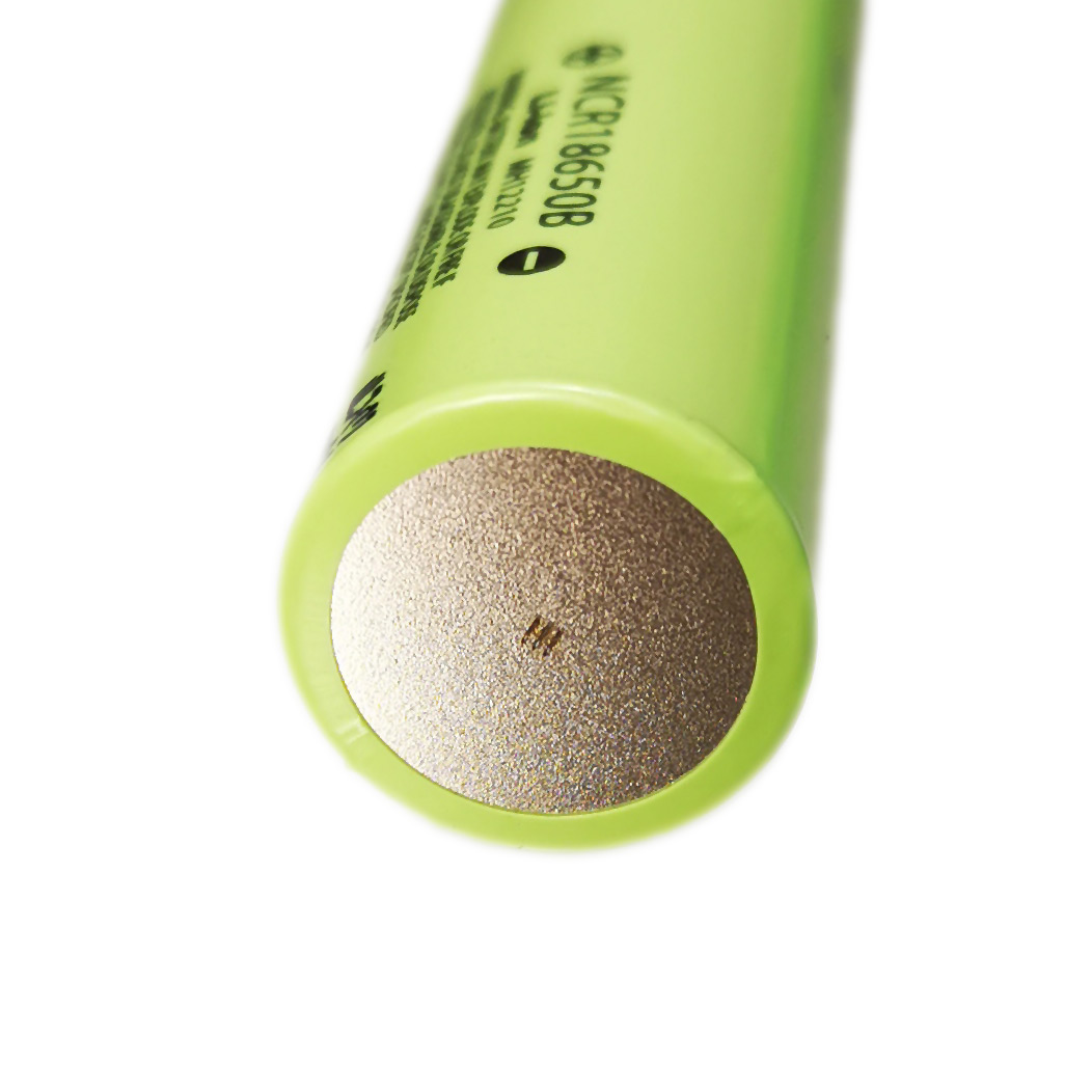

panasonic ncr18650b:
Discharge Curve
orbtronic has them for $15 each right now / 45g

Well, these cells have quite poor discharge rates and swell if cycled at max rated current without cool-off between cycles. They also have quite high Ri. Especially I don't like their shallow discharge curve. It might be good for very low-end applications, where SOC is determined from cell's voltage, but the cell itself is really expensive, so I doubt these will be used in low end applications.
crossbreak said:
panasonic ncr18650b are available since months. These get more than 250wh/kg and they are also rated for 2c. Sry I have no discharge curve for you :?
Those will perform awfully at 2C.
They will not perform too well at 1C either. Acceptable, but not too good.
Those batteries are fine though if you want a very large pack in a low power setup tho.
The higher the whr/kg, the higher the internal resistance seems to be.
There's no 'have your cake and eat it too' in lithium batteries just yet :/
