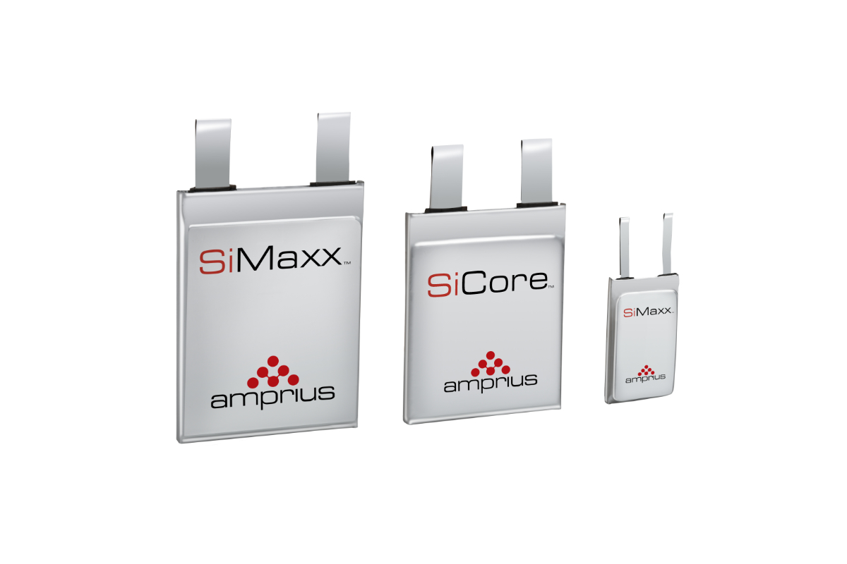

Amprius launching some new 400 & 500whrs/kg cells 😳
Amprius Broadens Product Portfolio with New Commercially Available Silicon Anode Battery Platform – SiCoreTM
Amprius Technologies, Inc. (“Amprius” or the “Company”) (NYSE: AMPX), a leader in next-generation lithium-ion batteries with its Silicon Anode Platform, today announced its all-new SiCoreTM product platform, an expansion of its product portfolio of industry-leading silicon anode batteries targeted to revolutionize electric mobility. In addition to this SiCore product platform, Amprius has also branded its existing silicon nanowire platform SiMaxxTM with its current product range of up to 500 Wh/kg and 1,300 Wh/L energy density.
The new SiCore batteries are based on an innovative, proprietary silicon anode material system delivering high-energy-density silicon anode batteries that surpass state-of-the-art graphite cell performance today. The new silicon anode cell chemistry is designed to offer high energy density, up to 400 Wh/kg, and long cycle life, as many as 1,200 cycles at full depth of discharge.
Who do i need to bribe to get my hands on these? :mrgreen:

Amprius mentioned that they were focusing on the commercial air market for the time being. Suggesting possibly that they were a bit expensive. They are well into the build of their new big factory in Colorado so they may have some consumer cells a few years out if we are lucky. Unfortunately for us with folks like Joby are well underway (They just received FAA maintenance cert) to setting up air taxi service in a few markets, may keep current capacity fully absorbed. Lots of other folks snapping up what crumbs are left for their flight equipment as well as the gov contracts that have been taking a good chunk.
