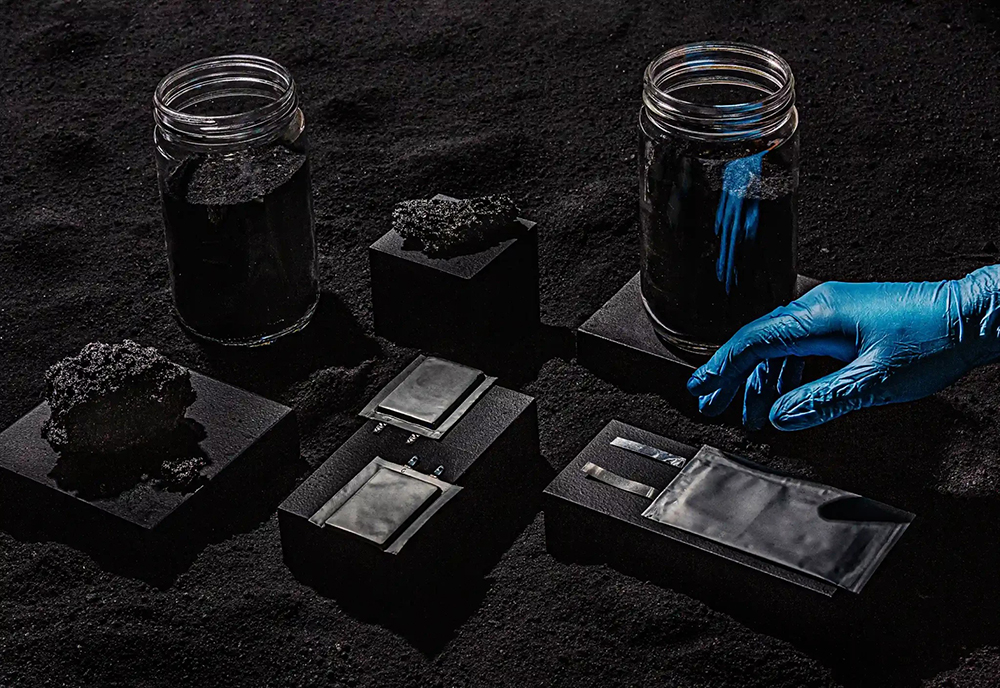

BTW, I completely forgot to post this a while back:
Quote that matters:
"We're already in the phones of the largest mobile phone maker in China," he says. "Does it start with X?" I asked. He smiled and said, "Actually, no. I'll say millions of phones in China have our materials." A quick scan of Huawei's website shows multiple charging-related benefits, and rumors of new products having silicon batteries.
Group14 also made it public that ATL, a large Chinese battery manufacturer that led Group14's Series A funding round, received its first shipment of SCC55 in early 2023 for use in smartphones.
Heavy emphasis on ATL.
There's quite a high probability that CATL is the next one in line to release XHP (Extreme High Power) HE cells using this anode tech, aside from Molicel. There's also a high chance that CATL has the clout to make an Si anode LFP cell because of this...
Now that would be interesting :)
