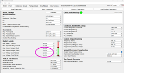

Also you asked earlier about my battery and phase currents. I've attached the Basic Setup screen for your perusal.
BTW, I notice you have max regen voltages set to almost three times your battery low voltage. Was that deliberate?
Just asking because it seems like one of those "has" to be wrong, wiht LVC at 19-19.5V, and max regen 59.5-60V.
Unless you're just setting LVC so low so it can never shutdown from LVC, but are still using a regen voltage appropriate for your battery voltage.... :?
The only thing I use in the Phaserunner software is the ability to set the electronic freewheeling. I've never looked at any of the other settings, so I can only assume they are Grin default values. AFAIK, those values have been there for the past 6 years. I have had problems with regen in the past when I tried to set them to speed limits to start regen at 42km/hr. I like to think of regen as a safety feature. You'll take off less skin going 42km/hr or slower on a downhill run than you will at 65km/hr or higher on a hill, though 65 is infinitely more exciting. Maybe the problems I've had with regen are related to the regen voltage settings. I'll run it by Grin support next week.
