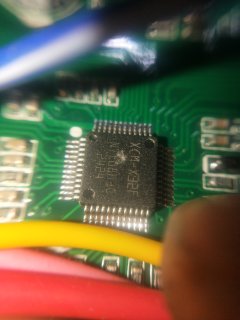

Hi everyone,
I recently installed a new controller on my electric motorcycle, but now I'm having an issue with the throttle response. It's extremely sensitive — even a small twist causes sudden acceleration, and it's very hard to maintain a steady speed. When I slightly reduce the throttle, the motor almost completely cuts out instead of decreasing speed smoothly.

I don’t know the exact model of the controller. In Turkey, this type of controller is sold as a “performance controller with custom software.” It’s a Chinese-made product. The main microcontroller has “XCM-X32” written on it. The controller has 18 MOSFETs and is rated for 72V, 42A.
Unfortunately, the manufacturer or seller does not provide any information about programming or configuration.
If you could show the *outside* of the controller, including all it's labels and markings, it'd be more likely to help us help you find out something about it, or see if we already know something.
A link to the sales page for it may also have more info.
From what's been posted so far, It is likely that the controller itself has no user-alterable settings, and that it's throttle control only controls the speed of the motor, not the torque. With a high torque system this can cause the problems you're seeing.
One possible way to help tame this is to use a device between your throttle and controller that also measures battery current between battery and controller, and is set up to limit throttle into the controller if battery current goes up too fast or goes above some limit you would setup.
The Cycle Analyst from ebikes.ca can do this but it is rather complex to set up, because it does a bunch of other things too, and you have to be sure they are all set up for the way you want to use it. There was also a device call the Throttle Tamer from ZombieSS here on ES, though it doesn't monitor battery current, just lets you adjust the throttle response curve. I think another device was made by a user here, but can't remember the specifics.
There's a thread about the Tamer's development, but I don't think it has enough detail to replicate it. It used a small MCU and some potentiometers to do the job, but if you're good with component-level electronics design you could do something similar in analog electronics. Probably easier with an MCU and coding if you can do that. (I can't)
Alternately, replace the controller with an FOC type controller that uses throttle-torque-control, and set it up to respond the way you want. Simply because it uses throttle-torque control it would behave better than a throttle-speed-control type system, but most can be tuned for best response for your setup and usage. But, like the Cycle Analyst, you'll have to completely go thru all its' settings and make sure it's correctly setup for your system, motor, battery, etc, as they're not really just plug-and-play type devices.
