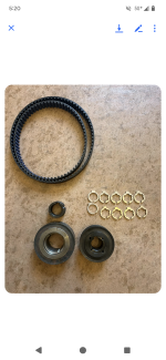

Was also able to source some parts for the pulley drive from a nice guy off Facebook. Making progress, hopefully have all the parts besides the battery in next week or so.

I was also able to find a pully for the transmission from a local shop . Happy with the result, the motor side pully is at a machine shop to fit the Qs motor. 1767112430033.png

Have things to the point where the motor is ready to be mounted, however held up on mounting the pully to the motor. The QS180 comes with a shaft that is cut for a sprocket to be mounted. My initial plan, and given how this is progressing might need to change course. Was to just cut threads for a bolt to secure the pully to the motor. Drilling a hole in the shaft of this motor is turning out to be an issue. I assume its hardened steel at this point.
I am going to pick up a carbide drill bit and see if I am able to drill any further. If not figure these are my next two options.
One have the face of the pully machine down a bit, so the keeper for the sprocket can keep the pully. As it stands now the face is a bit to proud for that to work. Then have two holes machined and tapped to bolt the keeper.
Second option take the motor to a machine shop, and see if they can drill a hole and cut threads into it.

Dropped the motor and pully off at the machine shop after wrecking more drill bits. Going to try to drill and tap the shaft if that looks like it wont work. The pully will be ground down, and the keeper will be have holes drilled and tapped into the pully. Might be two weeks before I get the motor back however. In the mean time on to wiring I suppose.
