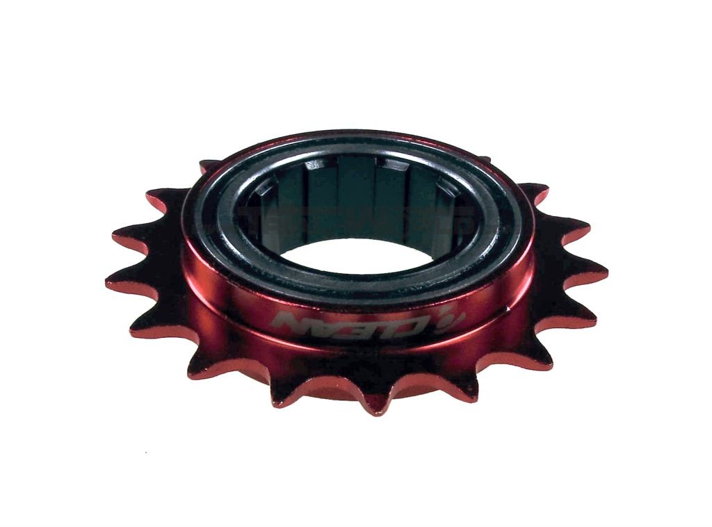

If you're not dedicated to regen or wanting a freewheeling motor, you could set up two single speed freewheels on the freehub and keep both chains on the opposite side of the wheel from the disc. One would allow motor to drive or not independent of rider effort On the second freewheel. They are available from the trials guys.
I'm not a huge fan of running two chains on the right but it is an option. Especially if you could mount the motor sprocket directly to the hub. It wouldn't let you build tep reduction stages for the motor very easily though which I think is important if any real climbing is the goal.

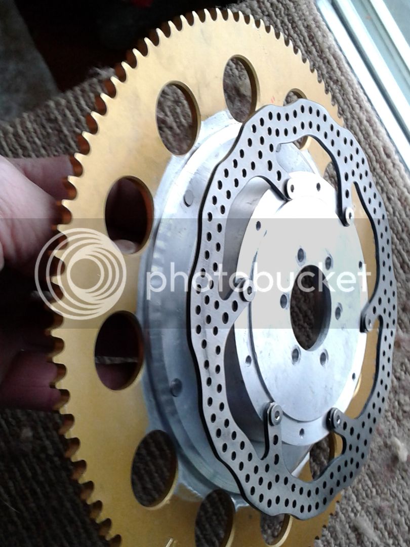

Got a left side brake - sprocket hub prototype turned up and fit. Started with a 6" round 1" thick billet which was a bit wider than needed, but I needed to explore the envelope limits so it was a good starting point.
The 1 inch thick hub is doable, but, I am needing to minimize the sprocket mounting hardware protrusions and bend in a few high spokes, and possibly limit tire width to something more like a 1.95" to avoid some slight chain rub or move out the brake assembly slightly on a standard mtn bike rear. If you go 1 inch thick, IMO it would be good for a wider fat bike hub -rear spacing. It does look like it will work reliably and should handle motorcycle power if the hub brake mounts can handle it. I have a 3/4" thick x 6" round billet on the lathe now that I may try next if time avails to see if I can get it to clear with less interference on a standard Mtn bike rear and not fight too little caliper clearance. Should work if I minimize the centering shoulders for the sprocket and rotor going by some quick deciphering.

Thanks for sharing the link. Most definite, a great way to go on large spiders and sprockets. Heavier Brake rotors cut to share sprocket mount hardware would be trick. Higher kv motors need much larger sprockets than what can be commonly found in kart chain options. What chain are you running.
I'm running #25 chain which fits onto 1/8" aluminum pretty well. I beveled the tips of the teeth a bit by spinning the sprocket against a file. No problems with greasing my rotor or pads so far. It might help that my sprocket is larger diameter than my rotor so oil gets flung away from the rotor.
Not at all worried about rotor getting soiled. Certainly a good point to use caution on chain lube choices. The dry film-forming foaming moto chain lubes should be perfect for the 219 chain. Care certainly to make sure overspray aims away from the rotor as one has to do now with them not getting all over clean painted surfaces in the sprays wake. Worst case, a chain guard could be added to the sprocket as another barrier. Belt is also a option long term.
Was thinking of 25H for my small block size setup with a left side direct drive. Using 25 on the primary side of the old GNG and you can pack a bunch of teeth on a small size sprocket with it allowing much higher reduction ratios. Nice and compact also. How far apart did your sprocket and rotor end up. Mine is around 22mm, leaving a few extra mm to clear caliper. Still may be possible to set the rotor a bit deeper (into slight C-bores) and not move the caliper at all. Looking like 3/4 thick hub may just work with calipers that are compact on the back side as are some of the shimano ones I noticed were.

I have about 12mm between the sprocket and rotor. Since the sprocket fits around the caliper, I have it spaced away from the hub centerline for tire clearance, so there is 18mm of clearance for the caliper.
18mm will not clear one of my calipers. 3/4 stock should work for most with a bit of caliper move. Still looking for stock 2pc rotors with rivet circle diameters to match or be made to match stock sprocket BC.
Nice spacing the tooth ring of the large sprocket outboard. Clever solution to the tire clearance issue. The Kart sprockets I have been playing with are thick (close to 5mm) and can be thinned a few mm in the caliper area allowing a bit more tire clearance and less offset. The added benefits from regen, improved throttle control, and having a super strong chain are worth doing some more study.
