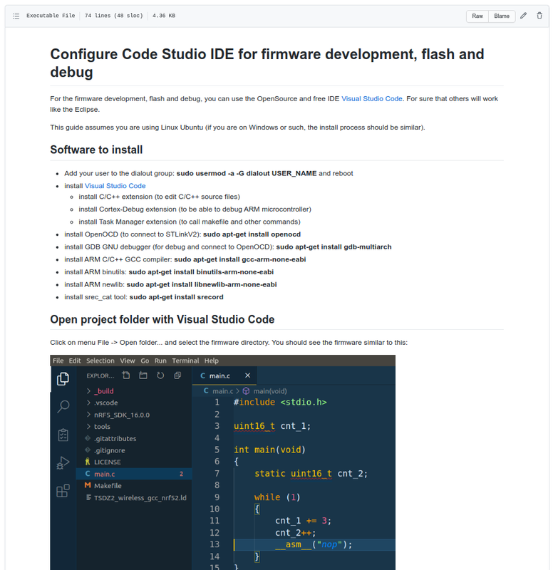

I wish to use the GCC as that is an ARM Cortex M0. Ideally I will reuse a Makefile from NRF52 (TSDZ2 wireless project) and then use Visual Code Studio to build and debug the code, which works very well.

Like this: https://github.com/OpenSourceEBike/TSDZ2_wireless/blob/master/EBike_wireless_TSDZ2/documentation/development-flash_and_debug_firmware.md

For the TSDZ2 wireless project, using Code Studio, new developers just need to open the project file and everything is ready. Sure, they need to previously install the GCC compiler, OpenOCD, etc.
That 2 hours is a good filter as anyone that plan to develop will need for sure much more than 2 hours!!
I remember to be difficult to install a plugin on Eclipse, for being able to debug for ARM, and then I switched to Code Studio. I still use Eclipse for other projects, like Garmin apps. Comparing both, I really prefer Code Studio because seems to be faster to open and use. Also I can configure much faster the debugger for ARM then in Eclipse.
And I am now experienced to use it for other project tasks like writting the documentation files with live preview:
I just added the very initial firmware. It has a Makefile that builds a blink LED code. The Makefile, linkerscipts and startup code were based on this repository: https://github.com/SeanBurford/xmc1100 , which has a few examples including instructions on how to flash and debug using OpenOCD and GDB.
My next steps will be to configure OpenOCD, GDB and Visual Code Studio, and flash and debug this code on the hardware.
I got the Flashing and Debugging configured on the Visual Code Studio and I wrote a page documenting the process for other developers: https://github.com/OpenSourceEBike/TSDZ2_motor_controller_v2/blob/main/Documentation/how_to_develop.md
